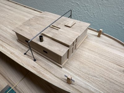

Are you giving any thought to "painting" with alcohol based aniline dyes?
Using that method is easier if the wood is dyed before assembly.
I am not sure about white. A whitewash may be necessary. There is no problem with gloss.
The grain is still visible.
Shellac and how many coats determines the nature of the finish and has a completely effective reverse gear.
I have the thought of using Renaissance Wax Polish over the shellac, but a test on scrap first.

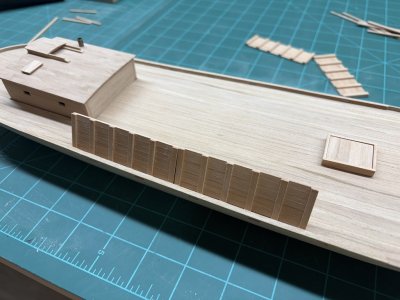

This is an interesting optionI was imagining a transparent color contrast of the deck house - hatch combing - topside - portable walls from the deck.
Paint is way too much for what I am imagining. That it is Cherry still needs to come thru.

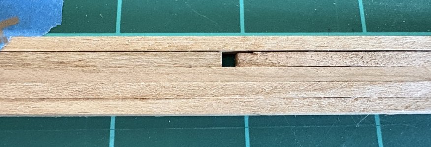

Your technique is belt and suspenders - the better option. The socket will be of help in keeping this furniture 90 degrees vertical. A Parkinson's twitch should not displace.The first step is to carefully measure and then mark their location on the deck. This is really a measure twice cut once situation as the work is invasive and a misplaced hole is really hard to remedy.
In some ways less difficult. The work could go as follows:How much more difficult would it be to have made the holes in the deck planks before they were bonded?
