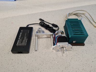

here is a picture showing the control box, the Nema 17 stepper,the bracket holding the motor, the coupling between the motor and the drive shaft, and the power supply.
I have two other steppers and the appropriate hardware.
The box looks nice, but it's an old card, has a firmware that I am not familiar with, and not easy to connect.
