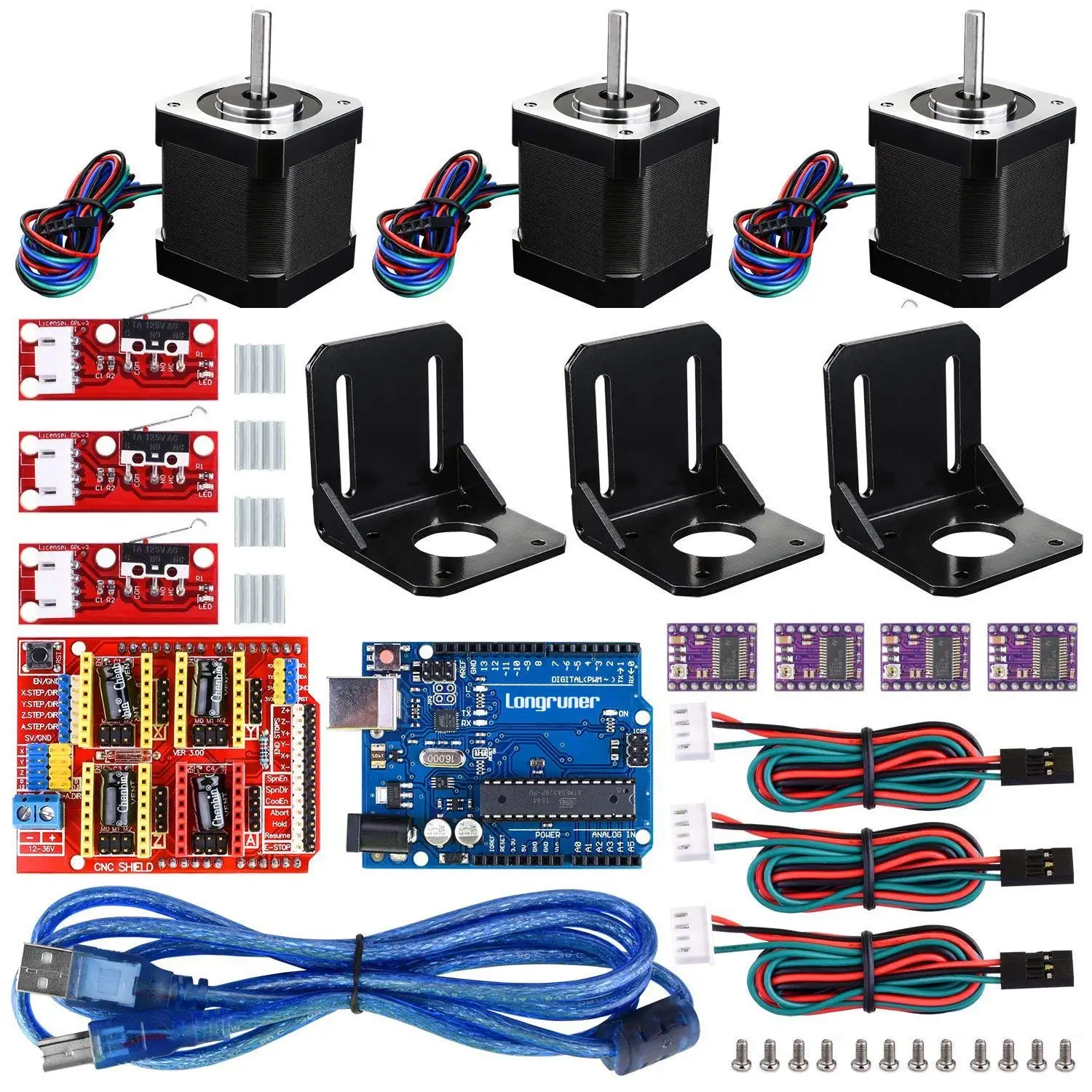

I got my MF70 CNC conversion kit from ebay Canada. The kit came with a controller that has ESTLCAM firmware installed on it. I don't know if Ebay AUstralia has this kit or not. There is also the following, which I find expensive, but it looks good:

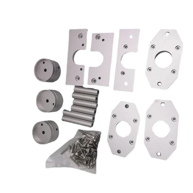

Here is another one that I found:
