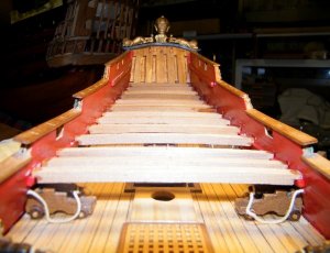

Looking aft across the beams,
and a close up view, I was lucky installing them as they will not need to be sanded,
the planks run over them nice and smoothly, see next pic,
showing a plank laid over the beams,

with the beams in place the next step was the making and attaching of the different gratings and ladder ways,
after cutting the grating to size I glue it with a dab of PVA to a piece of paperand then attach the coamings around it,
Finished grating, this one is for the very top deck,
The gratings made up and attached on the quarter deck,
overall view looking down on the waist area,
The ladder in place on the fo'c'sle deck,
Close up view,
The gratings and coamings in place around the Knights head and ladder,
overall view,
another close up,
