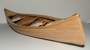

This is what the 17-inch canoe looks like as of today: equipped with the decks.
Have to do a bit of cleanup on the outside including light fine sanding and it will be time for finishing.
I know, some may wonder why the decks of my canoe models are much longer than the typical deck on the typical real canoe. Well, it makes for a distinctive look...
Keeping the proportions in mind, the decks on this canoe are shorter than what I normally do these days, but I do need a certain length to keep the appearance and shape in line with the others.
G.
I like the way that you overlaid your decks and then "stepped" them down between the innerwales. I also think that I see that you tapered the sides of the added floor boards on their ends toward the keel. That looks nice and I hadn't thought of it first time around. PT -2

Except for the paddles, this 17-inch canoe is finished:
Varnished was applied inside and outside.
Seat and yoke installed.
G.
Another very nice canoe to expand your fleet. With the numbers that it seems that you have, if an outsider saw them they may try to call for a rental paddle but you may talk them into a purchase if they have a carrier. I was thinking that you were going to install those nice carrying thwarts but don't see one. PT-2
