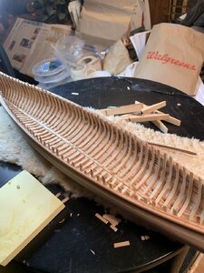

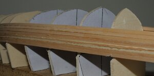

Installation of the ribs: one side at a time
Ribs are all in as well as some flooring and side strip:

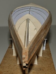

Update Aug 28...
A view of the gunwales and canoe sides (just for fun)...
At this point the inner gunwales are being installed (the glue is drying)....

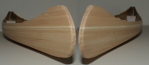

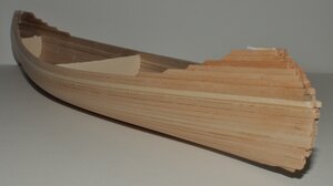

After a total of over 8 hours, the nails have inserted into one side of the canoe.
Here is a photo for fun...
The 17 " pear wood canoe is on the left: obviously still under construction.
The 17" cheery wood in the center. It has been varnish inside and out bu is missing seats and other parts
The 19" cherry wood also varnish and fitted (completed).
Quite a difference...
G
It is interesting to see how you vary the stripping for different appearances using your artistic license but as the originator of these that is fully in your domain. Very excellent work and precise touch with the nailing. PT-2

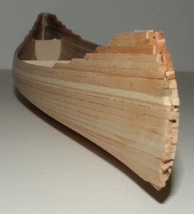

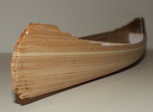

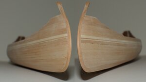

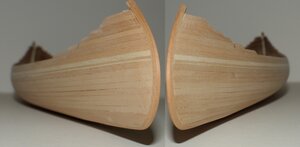

Update ....
The canoe as of September 2
Nailing is complete throughout the outside of the hull.

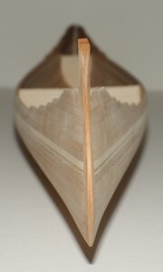

The keel has been installed: an extension of the outer-stem and running through the length of the canoe's underside.
Front view of the fastening on the outer stem.
The gunwale needing some shaping has been looked after since the photo was taken.
The inside of the hull has received its first coat of varnish prior to the installation of the decks, which will be done in the next couple of days.

Update ....
G
I like the double light accent strips with their variation in width. That stands out well from the rest of the upper hull and the subtle lower, waterline? strip. Nails on the stems are a new twist that you have brought forth . Great work as always on your precise part. PT-2
