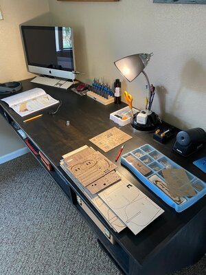

Well, just opened the box tonight and inventoried everything, all seems to be in order. Removed the keel pieces and filed the edge profile on the first piece. I will try to keep track of build time in the log. I expect to be rather slow and cautious as this is my first ship build ever. I will also have tons of questions as the directions are not so great.
Build Time So Far = 30 Minutes
Larry
I wish I could keep my work space as neat and tidy as yours good to see you start. Best thing (and the hardest) to do at the beginning is slow down, and check how the pieces fit together. Now is a good time to work out how to wire the LEDs. Good luck with your build any questions please ask.

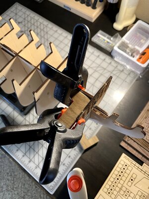

Good day today. Spent time working on the ship as well as getting my first Turkey of the year. Glued in all the frames and must have did something right because the deck went in without too much drama.
Total build time to date - 2 hours 34 minutes
Both decks went on without too much drama. Also drilled holes in all of the frames to run lighting. That is giving me some anxiety, have no idea what I want to light up and where to run it. Research continues.
made these small wood squares to try to keep everything lined up

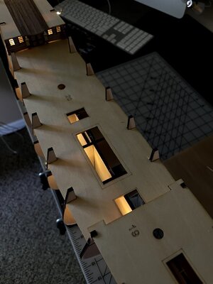

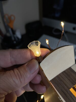

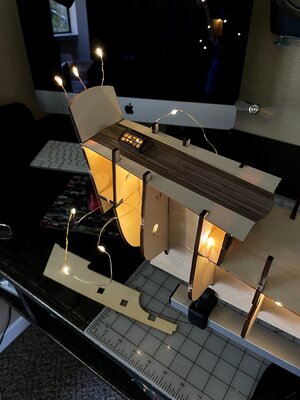

Ok, so you guys might think this was a silly idea but what the heck. I was thinking about led lighting for my ship. I like the idea of Evan Designs flicker lighting but wasn't keen on spending 75-100 dollars getting it set up. I started thinking about the led lights that I use for Christmas Decorations and decided to give them a shot. I think it's going to work out just fine plus they have a built in timer which I love. What do you think
Here is the three for the lanterns plus three on each side for the Captain's cabin.
I ran two inside of the entry to the cabin.
There are several below this deck but I think I will have to notch the frame so it can shine to both sides.

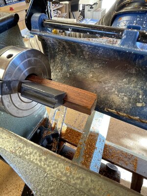

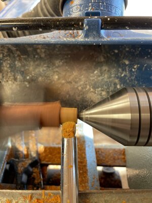

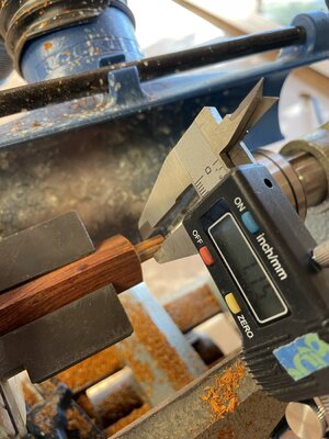

Okay, I know this is out of order but the Lanterns were calling my name. I don’t like the fiddly collars the kit provides so I decided to fab some wood ones on my lathe. They will require some tweaking when it come times to mount them but I think they will work fine. Process is listed below
Started with a piece of Cocobolo.
Drilled through and then turned to size
Finished product
I will be able to sand and angle the bottom to fit the ship.

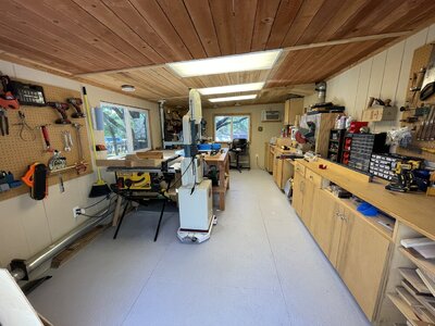

Did I mention I do a bit of woodworking.
Countoured size to lamp base View attachment 227758
Finished product
Much better looking than the standard parts, your workshop is fantastic I'm very jealous.

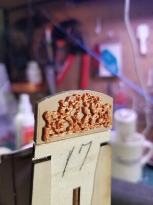

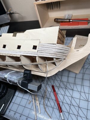

Planking is progressing even though I have no idea what I am doing, just winging it using information from this site. Also been fairing the planking as I go along. Seems to be working out. Any glaring errors or omissions you guys see? Also, what type of wood filler do you guys use?
