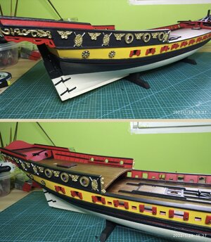

So - I have decided to paint some aspects of “Simons the Corsair,s” Xebec. There are some beautiful examples of painted versions E.g. @Lologaditano Jabeque Cazador:

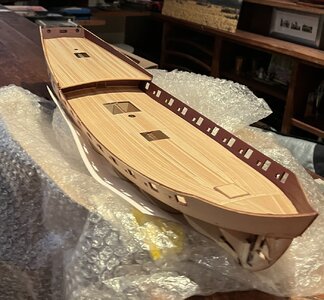

I went to go for a browny red almost a “hull red” inner bulwarks. This has been inspired from the Dutch Bloedvlag of the pirates back then. Simon was Dutch after all.

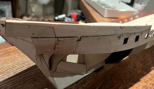

The stern bulwarks reduce by 8mm at the stern and 10mm at the fore part and extend by 20mm. Planked and being painted.
The bulwarks nailed and glued to the hull and cut and fitted some extensions for the stern.
I had to cut out the oar ports as my simulated closed ports did not work with the painted Bulkwarks. This is WIP and plenty of filing and fairing to do.

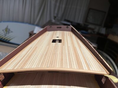

Decks worked a thin layer of poly applied.

This is where we are at:

The deck looks absolute fantastic Grant. I, On the other hand, do like the brown color you have chosen - it is refreshing after the plethora of red bulwarks which seem to adorn so many ships.

Very nice finishing of the deck planking, Grant. And the color of the bulwark inside looks fine.
That deck looks soooo good! Thanks for the compliments Grant, makes me humble.
Nice extensions on the aft and I do like the brown paint.

Good afternoon Heinrich. Thanks for the compliment. I gave the red brown some serious consideration. I tested Red Matt, Red ochre and a more red rust but they all were too overbearing for what I have in mind. So went for a softer red brown. I like it a lot. Cheers Grant

Geez! that's very nice deck planking - love it.
The decks look excellent Grant! Perfect enough to be on a schooner! ;)

Geez, miss a couple of days reading your log and now see you are almost done. I like the the deck color combo.
Jan
Thanks Jan. Yep - I had to mix a hull red and some bright red to make it less brown. I really like the colour and am hoping it carries through nicely. Besides the redesign of the main deck everything else thus far has been very simple so does tend to go quickly. Cheers Grant

Hi Grant,
I noticed you make a "big" hatch at the bow area just what I did. This should be a smaller hatch conform the plans of OcCre and also seen on other models. I made it bigger because I had my measurements wrong. You can still correct this is you like. I let it be, because to me it wasn't that much of a problem.

Good morning Peter. I have not noticed that. I thought I used the Cazador plan scale, perhaps I followed your lead and
Measured incorrectly as well. ;) . I agree with you on most European Xebecs (Le Requin and Le Indiscret E.g. ) these hatches are smaller. I may have to leave it as this hatch fits in between the raised deck and I can’t see a solution if I had to make it smaller. Cheers Grant
