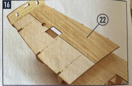

Was this a pre-engraved/pre-printed deck?
Hello Johan. It was not. Here are the kit upper deck :
I lengthened the stern of the ship so therefore the transom is smaller. The planking is a simple 3 butt system with only 2 rows of treenails. I’m looking for a more open feel to the upper deck. My deck pattern of the whole Xebec is based on the Le Requin but simplified significantly. Cheers Grant
View attachment 357511View attachment 357512
No, lime strips that needed to be glued on the false deck which Grant did exceptionally well.
