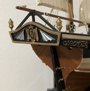

Yes, I added my lights. I felt like they were missing. So I used Artistic License. ;)91F29CEB-C85E-479D-ACD4-1D6D5427B4CE.jpeg

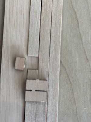

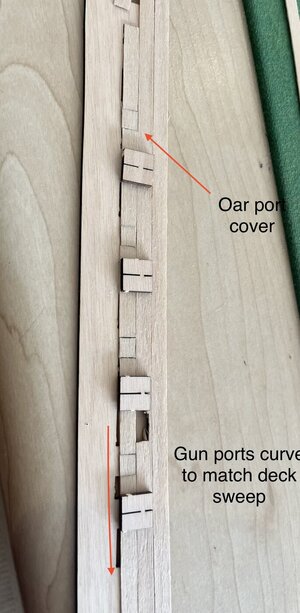

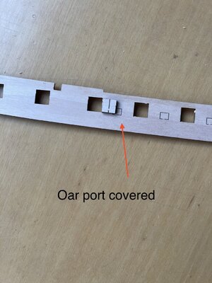

Ricochet Rabbit Grant- I am looking at how to change the bulkwarks. The kit has 2 gun port lids per port. In all my research I have not seen a Xebec with this configuration.
I most certainly want one lid per port. These will be open while the oar ports will stay closed.
Modifications required :
I cut out the cannon ports from the kit bulkwarks and am keeping them as one unit.
When placing them as single gunport lids the lid covers the oar ports
I know my limitations and to recut each little oar port accurately would be a clown show.
I decided to rather simulate these adjusted oar ports (Closed) as I plank the bulkwarks using just the lime 0.6mm strips.
I cut the lime to the length of the new port position. Using the width of the lime plank, I just left a gap the size of the oar port. I place the gun port lid to ensure all is correct.
I cut out the oar port lid from the lime plank (I just used the width of the plank- was so close to the actual size (as you can see from in the above photo). I Had some luck here:D:D.
Each oar port cover is lined with pencil so these will be identified and not lost in translation.
Result so far :
I will be changing the last 3 gun ports to match the curve of the deck line which flows all the way to the transom of the upper deck. See the curve of each veneer plank which creates this line.
Cheers Grant
That's a great modification Grant. I did not replace the position of the oar ports and so the gun port lids do partly cover the oar ports, so great alteration from your part! I also keep the gun port lids as one and just cover the whole with veneer. :)
I like your approach to the lid part....keep up the great work...

Very nice touch to have single piece gunports.
Moving the oar ports; oar ports means oars means rowing banks? Do you now also have to move the rowing banks, or aren't there any?
Clever innovation with regards to the oar ports Grant. I fully agree -trying to cut those small square oar ports can only spell one thing - unless you adopt my pumice stone method to square the ports. But that would need a pumice stone cut/grind down to the exact dimensions.

Great solution Grant! ;)
