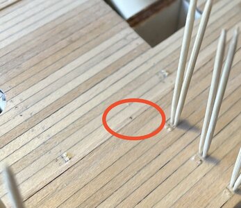

Good morning. Grants first attempt:

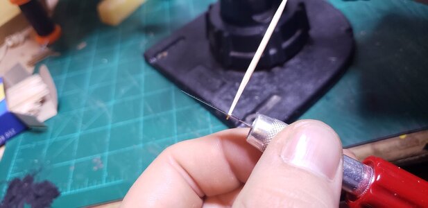

Treenails: As mentioned I want these to be non distinct. At this scale this is difficult and perhaps a simulation may be better than actual wood. But I wanted to give it a go.
My process:
I do not mark the deck or make a stencil for these. This is my preference as I’m not wanting that perfect, immaculate model finish on my Xebec.
Used a small center punch to mark the position. This may be my first error. I did not see this with natural eye, but this distorted the wood. I should have use less pressure in this application- Indicated.
I used a 0.4mm drill to try and get these as small as possible.

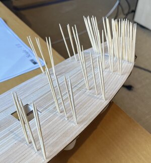

Used Bamboo toothpicks - very thin ones. Some of the tips where still too thick and I have gone through plenty packets so far.
WIP -
This is what they look like after a little bit of sanding. Once all the treenails are done a final sand or scrap will be done.
Oh the red circle. On my dividing strake metal nails are used. I was a clown inserting these before finalizing my deck finish- going to cause some problems :rolleyes:.
Whilst I am happy with them (colour perfect) the distortion of the wood from the center punch is visible in close up photos. Plenty finishing and sanding to be done so may still improve.
Cheers Grant
My process:
WIP -
Cheers Grant
My process:
WIP -
Cheers Grant

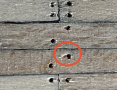

Hi Grant, do not worry about the extra hole. Just a bit of glue mixed with some sanddust will do the trick to fill the hole...
My main disappointment was the initial center punch distortion and to be honest with 3mm planking, even the 0.4mm treenails are a little large.
This is the exact same reason why I withheld from adding treenails to deck- and hull planks. This, coupled with some pictures from Batavia's deck, led to my decision not to add them.
Granted, there are those gifted among us, who can pull this off very convincingly, but, unfortunately, I'm not one of them.
This also extends to chaulking, The smaller the scale, the more difficult it becomes to get a consistent, realistic result. Again, there are those who master the craft, but it's a very tricky balancing act.
Having said that, so far your treenails look terrific, wonder how they look after scraping and applying some finish.

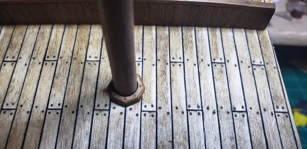

Hello grant.

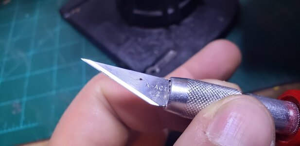

I used one of my micro drill bits to drill a hole in one of my blades to act as a small draw plate. I would insert the tips in to the hole in the blade and then go a use the same size drill bit for the treenails for the decking. This is how I did it on my independence that I put to the side. Pics at the end are after it has been stained with Danish oil and satin poly has been applied. 20220421_063436.jpg20220421_063454.jpg20220405_141244.jpg20220504_234958.jpg20220506_012149.jpg

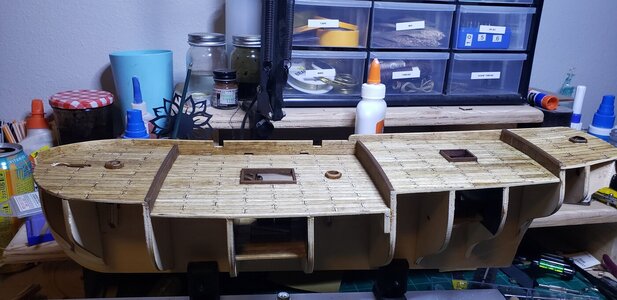

I like that you went with a GM3BSS (Grants Modified 3 Butt Shift System) for the deck :). No matter how many photos, images or actual ship plans I’ve looked at and compared there seems to be no fixed pattern common to all vessels. So some model makers leeway makes sense to me. Those curved planks look good and give your deck character too.
Your thoughts about the treenails has me re-thinking the value of applying them for the deck at the smaller scales. I admire you attempting it though because I think I’m too chicken to risk it on my deck :D.
Good morning Peter. Thanks for this. There are one or two spots where I will do this. I will have plenty of saw dust for this for sure. Cheers Grant

Good morning Johan. I am very happy with my deck thus far. It is in Grants imperfect style but the more I work it the more I’m enjoying it. I am always in awe of those guys who pull off everything just so. I mean I can’t even cut a strake at 90 degrees ROTF.

Hello grant.
I used one of my micro drill bits to drill a hole in one of my blades to act as a small draw plate. I would insert the tips in to the hole in the blade and then go a use the same size drill bit for the treenails for the decking. This is how I did it on my independence that I put to the side. Pics at the end are after it has been stained with Danish oil and satin poly has been applied. View attachment 354919View attachment 354920View attachment 354921View attachment 354922View attachment 354923
Good morning Derek. That is a good idea. It would have made the toothpicks hold a better shape and insert into the holes way better. I did think of Danish oil but I am very keen to maintain the light composition of my decks. Subtle caulking and treenail is a definitive objective of mine for my decks. Not sure if I will achieve this…..Thanks for the advice tho I will certainly keep this in mind.

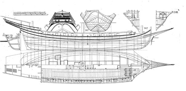

Good morning Roger. Thanks for this. I have enjoyed coming up with my deck pattern. The main decks of Xebecs vary significantly so I did have a license to play :
E.g. French Boberach (many Arabian Xebecs have the same ):
French Le Requin (I am doing my decks in this pattern)
The Spanish more traditional deck patterns.
And it is common thought (although not confirmed) that the Barbary Pirates had a very haphazard deck pattern similar to the Dutch vessels of the time.
As for treenails in small scale- yep I would not do toothpicks again- difficult to make them small enough. I think if one had to calculate the actual size of a treenail at scales smaller than1:60, that it would probably be a pin prick or smaller.
