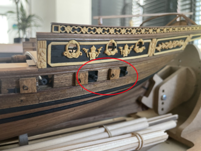

Hi Grant,
With Cazador 4 pieces of pin-cannons are provided within the kit. These pin-cannons are the wrong size and also they need to shorten a fair amount because they're much too long. The position of these cannons are below the quarter deck and it doesn't look right in my eyes. In my kit 4 extra normal cannons were provided as well, so you have an opportunity to open this part up underneath the quarterdeck and place normal cannons.
Check the ammount of cannons, if there are 24, then you're safe to do this.
I didn't do it, and do regret it.....
Hi Grant,
Good morning Peter. Thank you. I will check this for sure. Every picture of your Cazador is so beautiful. Your scratch decorations which you have change from the kit design are exquisite. I also see you went for a single gun port cover (I am also thinking about this.) Thanks again. Cheers Grant
Thanks Grant, you can do better, I'm sure. I didn't liked the double port covers, however that's a matter of personal preference. It's easy to convert them to single ones. Just don't detach the two single pieces and cover the front and back with veneer strips.

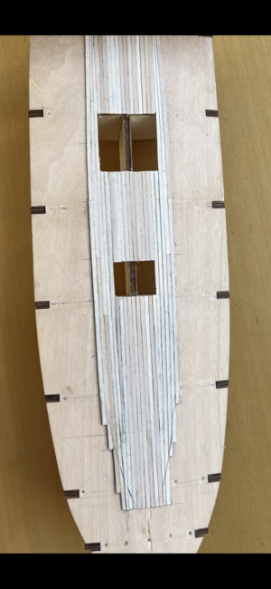

Good morning.
I have had 4 days to myself so plenty of ship building time - started on the Xebec. I will finish the Victory but I am at the boring part and need to wait for my Entrance from shapeways. (Great excuseROTF).
I have mentioned due to the lack of any information or references of the real Spanish Jabeque Cazador I am going to make my own Xebec. A little more outlandish and sexy.

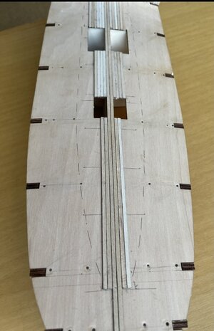

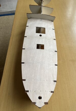

The deck went on easily and pull out 99% of the twist and warping. A minuscule warp on the bow false keel remains which will be easily rectified.
My first design change :
I like the main decks on the French Le Requin, so decided to build my own version:
The main challenge is the inner part of the deck is lower than the outer strakes. I also want the outer strakes to be marginally thinker than the inner deck planks to highlight the distinction.
I have some left over lime from the Victory first planking layer which are thicker than the OcCre deck lime which will solve the higher outer strakes. I cut each plank to 3.2mm so they are 0.2mm thicker than the inner planks.

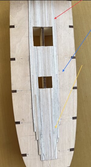

Off we go : Inner deck:
The inner deck butt pattern is of my own design. I am not going for accuracy at all with my Xebec. To achieve a curved effect I tapered certain planks and made a “dropper” plank pattern.
Butt pattern : Blue arrows
Tapering : Red Arrows
Dropper : Yellow

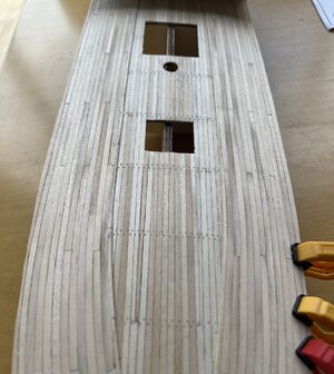

Treenails and caulking : At this scale and only 3mm, deck plank tree nails can look overly large and become way too prominent on the deck for me. I still want treenails tho so went for bamboo toothpicks which are a similar colour to the lime. They are there but won’t jump out at you- hopefully ROTF
The caulking I lighty coloured each plank with a 2b pencil. I want the tree nails and caulking to be subtle.

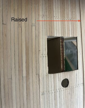

For the first strake of the outer part I cut a 0.1mm strake (this is my problem child). Red arrow.
The outer deck butt pattern is a Grants modified 3 but shift system. I had to wet each plank in hot water to achieve the bend at the fore part. I did &%#%%# one plank at the bow. You can see it on the bottom center left of pic below. I will play with saw dust and wood glue to see if I can repair it.
Work so far:

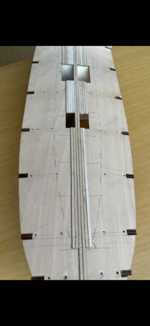

Good morning.

Good morning, Grant. You made a great start with this deck planking with your personal input. It looks nice with the added ‘planking details’.
I am glad to see that you are off and running on the Cazador, Grant. It is a very interesting idea with the raised center deck section - it looks GOOD!
Good afternoon Heinrich. Thanks. The outer part of the deck is slightly higher than the center. It has a small step down into the middle deck. This is a very simplified version of some of the French Xebecs. Cheers Grant
This is great stuff Grant! Let the mods begin! ;)
Good afternoon Dean. And so they have. I’m keeping the mods simple and using some other Xebec designs. I do enjoy the French based Xebec and some of the Corsiars from Algeria or the later Barbary Pirate look. I just found the Cazador from Occre a little clinical for the Xebec ship. Hopefully I don’t just stew this ship up totally :rolleyes: . Cheers Grant

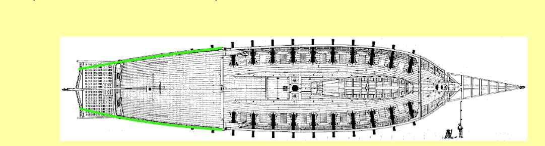

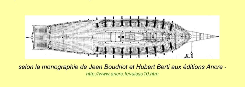

Hi Grant,
Keep in mind that the Monographie has an known error showing the correct green lines....
Good evening Peter. Thanks for this. I did not know that. I’m not going to attempt to
convert my Cazador to the Le Requin, that would not work. I am taking the deck and perhaps one or two details from the Le Requin but that is it. Strangely enough I rather enjoy the stern squaring out as in the Monograph and will probably extend mine like that. Cheers Grant
