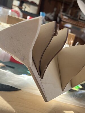

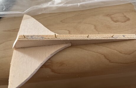

False keel and stern.
1. Stern and false keel extension.

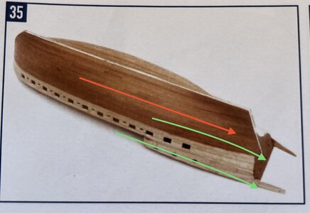

Besides extending the length I also want the hull planking to be less linear. Red arrow is the kit, Green my plan. The wales are also going to follow the deck curve rather than be linear as the kit plan.
How I am going to get the gun ports to follow the curve of the deck is going to be a mission o_Oo_O. Problem for another day.

Dry fitted :

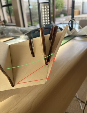

The Green arrow reflects the planking pattern while the red triangle the narrowing area of the false keel. (It won’t need to be so long) Test fitted some planks and all works rather nicely.

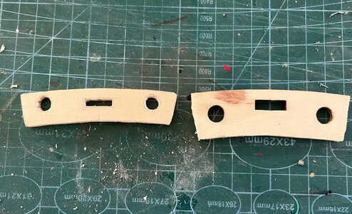

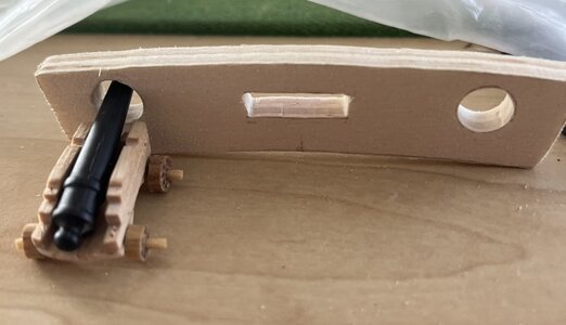

Changing Transom :

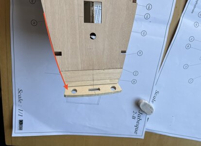

I originally was going to modify the kit transom how ever I did need to remake this as I am going to put 2 cannons on the stern deck. The rudder slot and cannon ports need realignment and the transom needs to be a lot smaller.
Made a dummy cannon for test fitting:
All seems good.
It will take a while to now sand and shape so all fits nicely and symmetrical. Let’s see……

Changing Transom :
All seems good.

Changing Transom :
All seems good.

I understand the green lines for your hullplanking. It is possible, keep in mind this is a mid-18th century vessel. The curvature of the wales are a bit less comparing to say early 17th century ships. However, it's still possible to do so. The natural curve of the bulkheads allready follows your green lines a bit...
