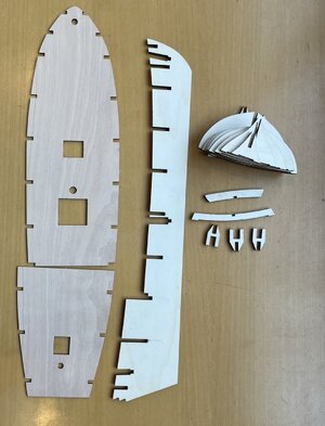

False keel, deck, Frames, mast and deck supports. Normal kit plywood but looking good.

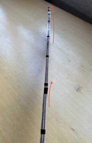

The false keel was warped:p. 2 out of 2. My Victory and the Cazador.
I wet the False keel and overnight put weights on it to straighten.

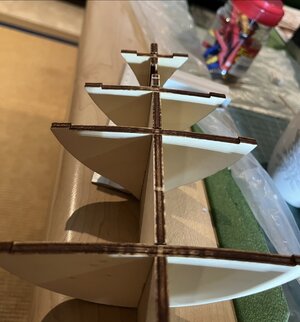

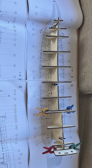

The Frames went in smoothly with no adjustment required-well done Occre! I used Lego blocks, a set square and continuously check the horizontal and vertical of each frame. Wood glue was used, however once the square of each frame was achieve I dabbed CA glue along each frame. This made sure the frame did not move while the wood glue was drying.
I got the bend out of the false keel 95% only. The plywood is very flexible, so hopefully the deck fitting will correct this. I think so:D….

The deck should pull the keel straight. Maybe it's a good idea to put that on first, and then go back to the Victory? Then it has ample time to dry and assume the correct shape.
Good morning Heinrich. That would have been a good plan. Unfortunately it is dry now. It is very flexible and with hardly any pressure gets to the vertical. I will have to see I guess. Cheers Grant
Hi Grant, with my somewhat limited planking experience I’m just throwing this thought out there.
Planking one side of a hull without doing the other side at the same time and in a similar arrangement can induce possible hull warpage. Is it feasible to force warpage to counter the warp you presently now have by gradually planking one side only?

Good afternoon Roger. Yep you are correct mathematically. For Grant to achieve this would just luck:rolleyes:. I think it is all solvable by the deck support. Let’s see. Cheers Grant

With a similar problem i glued a flat steel plate to a piece of flat MDF. Then rested the keel on the plate. With strong right angle magnets (the kind welders use) I was able to hold the keel straight and true. Smaller magnets can also align the frames or bulkheads to the keel. Would that help?
