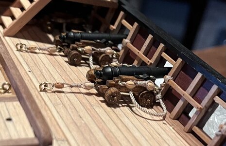

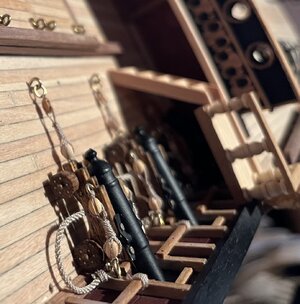

Grants cannons : As mentioned previously I am scratch building all my cannons. I don’t have much wood left so I have build the carriage up from 3 - 2x2 birch wood strips cut to different lengths. The wheels are cut from a 4mm dowel and the axles from a 1x2mm birch. I have nailed the wheel with 0.3mm wire. A sort of MacGyver type build.

They are stained with oak and I don’t want them all perfect so I make the stain a little irregular and “used”.

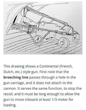

Rigging will be Dutch/French continental :
At this scale I did not attempt to include the hooks etc as these would be like 1mm and I could not make these so small….I would have if I could. Also if these are made there is little room between the outhaul and inhaul blocks and was just too crowed for me.
Brass fittings : I know many of you have a distain for brass fittings on a ship however from the start I decided to finish my Xebec with brass throughout. I also left the nails brass for the Trunion capsquare bolts - They just look cool:D.
Rigging: I rig each cannon on the ship and place a piece of paper under it so not to scratch the deck- “no finesse Grant”.
Result: I think the 3mm blocks are a little large….I am running with this as I have no 2.5mm blocks or rope. The breech ropes are 1mm and the length is determined by ensuring the cannon goes back enough for reload. All the rope lengths are done this way. Unfortunately this mean the breech ropes don’t have enough room on the deck between the cannon so I’m not sure what OcCre was thinking, and they overlap each other…..thinking about this problem…..

The angle of each cannon will be determined by the quoin and will all be included once I have rigged all the cannon so I achieve uniformity………ha so my logic tells me….ROTF. I will glue the cannon to the Quoin so they stay straight and uniform.

Hi my friend. I just love how you are incorporating more and more scratch-build aspects into your build. It is not only a clear sign of a modeler gaining in confidence but also in craftsmanship. It's a pity about you not having the 2.5mm blocks, but hey, we have to make do with what we have and that you are doing admirably!
These guns and tackles are looking very good - and correct.
The only thing, what I would do in principle: blackening of the eyebolts and rings, and the nail heads of the trunnion caps maybe
- but I have a principle problem, because I do not like the look of brass - but like everywhere in our hobby - just a question of taste

Just some very nice rigged canons, Grant. What can I say more ……..

Now a dedicated modeller would sand and shape each block individually to it's correct size. ROTF
