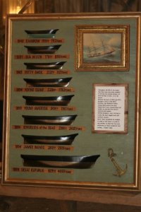

Because there were no reference materials available to show you the comparativeness and size difference of clippers. I built a plaque depicting many famous clippers..their weights, dates built and lengths all to scale to one another. The Great Republic was so much larger then the next largest(average) clipper it is just amazing.
