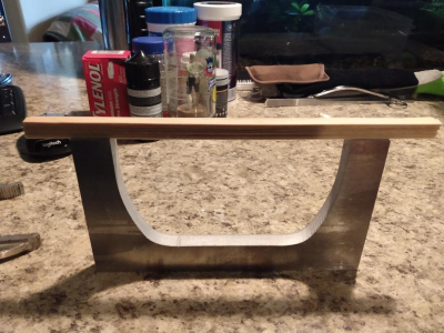

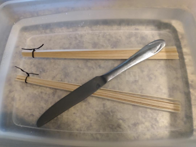

I'm now working on the frames. To simulate the look of hand hewed framing timbers I'm laminating 9 pieces of 1/32" Basswood together and bending the frame components to a rough shape. I start by bundling 9 pieces of 1/32" strips together and soaking them in hot water for 15 minutes.
I then remove the wire ties and lay the strips atop my form, centering them via eyeball. The strips are well oversized so there is room for error when centering. The fixture will hold two sets of frames at one time. No glue has been added to the strips. That comes later. I'm bending nothing but loose, wet wood.

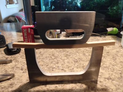

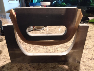

I then add the follower atop the strip bundles and center it up via eyeball. With everything centered, I start working the follower down by hand until I can't move it any further... then I use a vise grip to finish the job and compress the strips tightly between the two forms.

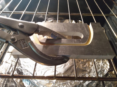

I then bake the form and wood in the oven @ 210 degrees for a while, until mostly dry, then let everything come down to room temperature.

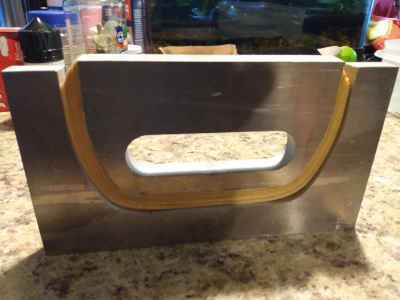

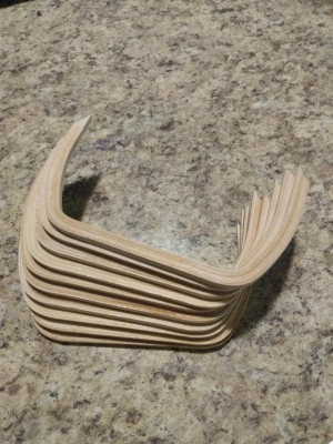

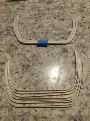

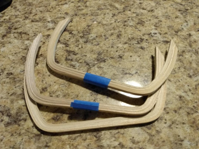

When cool, this is what I have. I tape the bundles together and put them aside. I won't do anything else to them until I have all of the boat's mid-sections of 18 sets of frames bent. I'll then return these bent frames to the form and start gluing them up.
Here are the 9 ply frames after being bent around a form. The individual components hold their shape really well, however. There is about 1/16" of spring back on each vertical leg. I keep the bent frames in their respective bundles until time to glue them together.

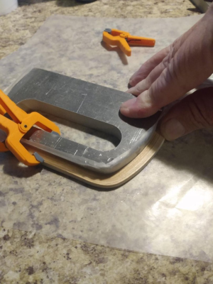

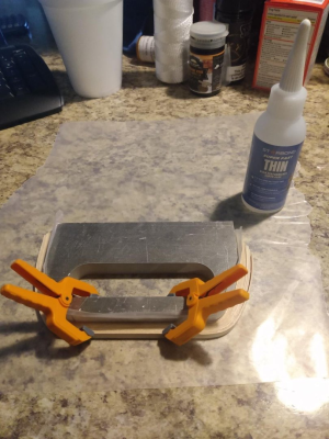

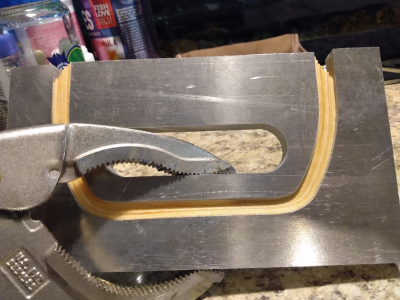

I start by gluing the flat bottoms together. I clamp the pieces in place around the bending form and then simply squirt CA over the laminations letting the resin soak in.
I then pull the laminations around the form and glue the rest.

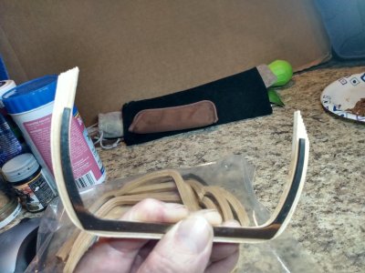

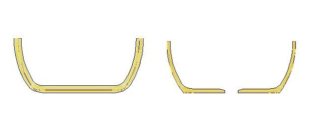

This is what I have after the frames are glued together. They are quite solid! Each one of these pieces will make two frame members. I'll need 36 individual frames for the mid-section of the gunboat. that will be 18 of the laminated pieces shown below.
Those laminated "U"-channel shapes will be cut and sanded to their final shapes as shown below. I currently have 10 of the "U"-channels glued up and I need 8 more to complete the mid-section. I'll then need to cut the bottoms flat on a table-saw and make a sanding fixture for finishing the sides. The 'inside' geometry of these frames will not change. It's only the outer geometry that I have to whittle away to final shape.

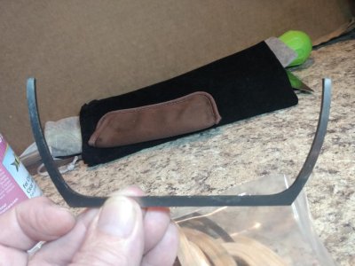

Progress has been slow due to the laser breaking and preventing me from cutting my finished frame sanding templates, but all is well now. I cut 4 templates yesterday. There will be 18 sets of frames to sand, so I cut 4 templates to prevent me from sanding away the edges of any one template and creating inaccurately shaped parts. I used stainless steel to make sure my templates don't rust should it take me a while to sand all of the frames. I'll attach the template to the laminated frames with either 2-sided tape, or rubber cement if the tape doesn't hold well enough.
Here's one of the sanding templates.

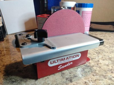

I'll rough cut with a bandsaw, then sand the frames to the template shape using my new Ultimate sander. No mess, no noise... I'll be able to sand frames while sitting at the island watching TV! There should be no noise coming from the Mrs. either! *Fingers Crossed*

You'll need to mount that sander to a base or give it some rubber feet... it will slide all over the island granite...
I use mine almost every day :).
