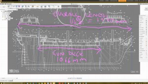

So here is the image below which I have scribbled on to show two measurements. The documentation says that the gun deck is 168ft/51m and the keel is 138ft/42m.
So does anyone know where exactly these measurements were taken from? I will then work out if I do 1/32 or 1/48, I would prefer 1/32 as thats a much easier scale for me to work on with my meat hooks.

Well I have begun the process of obtaining the length and width of the Bellona with the anatomy of a ship details. The only issue I cant figure out is if I have correctly identified the entire gun deck properly. I assume I have identified it correctly and have moved on with the process of reworking and merging the corel drawings into proper scale drawings with the assistance of the anatomy of a ship details.
This is going to take a long long time. No rush, after all I have The Hayling Hoy to build and the Blandford section to complete :).
As you can see the gun deck length at 1/48 will be 1066mm.
Here you can see an overlay with the Corel drawings with it scaled to 1/48. Have I identified the gun deck correctly. If I have this will be just shy of 2m, an impressive size no doubt but is it now too big as Brian mentioned in an earlier post.
