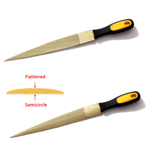

When shaping and fairing the frames, a coarse woodworking rasp with sharp teeth can be extremely helpful. It removes material much more efficiently than a fine file. If you would like to speed up the sanding process even further, you could also consider a small spindle sander. Compact models are usually available for under $100. However, these machines can be somewhat difficult to control when you first start using them, so there is a certain risk of removing too much material or damaging the parts. For most purposes, a woodworking rasp is already sufficient.

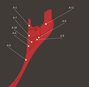

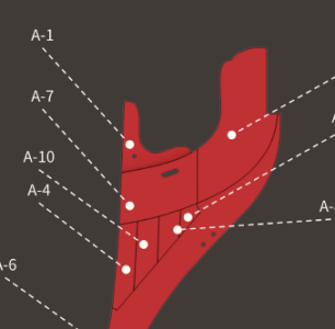

Thanks for the ideas on the sanding. I do have a question on the taper.
How gradual is the taper (I could not find a tapered picture in the logs.. but I might have missed it.) Is the taper sharply done on A6 and or gradually shaping across the whole face of the bow assembly? Also vertically how far down vertially does the taper go? Pictures would be really handy.

It is all available in various books and sometimes even better contemporary sources such as drawings and contracts found on archival type websites.
In general the taper was about half the breadth where it meets the stem, but specifics for the late 18th century and early 19th century are given on pages 218 and 219 in Scantlings of Royal Navy Ships. According to The Elements and Practice of Naval Architecture, for a 28 gun ship the taper goes down from 11 1/2 inches to 4 inches. There is what may be better information found in an appropriate contract. In the case of Enterprise (28) 1774 the contract for Aurora (28) 1776 could be the most accurate source for any scantlings. The taper is not as severe according to the contract. and it is also about 20 years before Steel's book so hopefully more accurate for the time period. The size of the stem should also be taken into consideration.

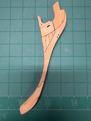

For the stern, there are templates in the kit. Here is a good picture that I snipped from Arban's build in his log. NOTE: This is before he attaches G1-2. It gets tapered again after they are installed.
