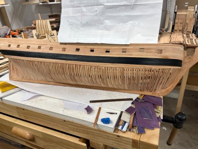

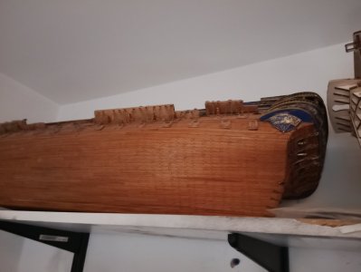

One last planking update before I go back to lower decks.
First coat on the wales. Starting to actually look like a ship.

Good morning Tim. This is so good. I wish you would do a log just so we can see how you do your work. Looking at your hull planking I see you have correctly used the Top and Butt planking pattern. I was wondering how you cut the planks into this pattern so accurately ? I have tried a few attempts and failed miserably Kudos on the notched planking by some of your gunports as well- its not often we see this. You are owning this Enterprise. Cheers Grant
Grant,
Thanks for the kind words but too far along to start, too lazy to take all those pics.
First off, realize this planks come pre cut, BUT, and it's a big but I had to custom fab a couple for the Wales and many of them, particularly toward the bow and stern had to be altered, mostly be planing angles. Here I use a small violin plane that is razor sharp and set to shave little curls of wood about 1/2 as thick as a sheet of paper......one of my most useful tools.
If you are custom fabbing all, IMHO, since they are all very close as to angles, you make one solid "prototype" master then trace everything from that. biggest variance is that final planks running to stern are longer but same angles as others.
That said, here is where gap filling CA and long brass bar clamps come into their own. When planks are fit, especially ones that need to be heat bent [I use a heat gun over a form with a moistened plank] once they are clamped through the frames, there are usually less than ideal gaps. One of the beauties of the medium CA it allows working time. Once clamped the brass adjustable bar clamps go from frame tops, plank bottoms to close up gaps.
Works great but sometimes small gaps remain and the CA with fast sanding to fill gapyields zero gap, ultimately using a very sharp, very light touch with a #11 blade to yield a small parting line.
Personally I have never realized a suitable result using Titebond on planking. Also use CA on all lower structures. Here is my almost finished forward platform, once It's lightly sanded and finish applied the result seems appealing to my eye.
Hope this helps.
Tim

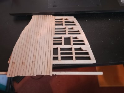

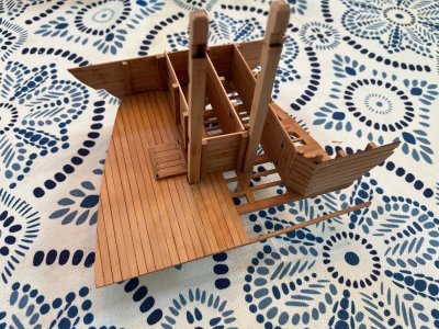

Tim are you not marking Treenails on your deck
Mine is below with Planks Goggled
Will trim as i fit to Ship
I have always drilled and pinned (1mm stuff rounded) my planks
See My San Felipe Best planking i ever did
Not sure this is practical - looking at marking with tiny Marker pen On the beams

These kits from China are A Giant Leap for Modelship building
Until you see the quality of wood (Pear) and detail of cutting Its like a new Century
The new Surprise from AL Still has the very clever but impossible DEcks where they are precut but you can "see The Joints" and they spoilt the model
Much better to plank it yourself and then it can be "Joggled" and Treenailed as you want
