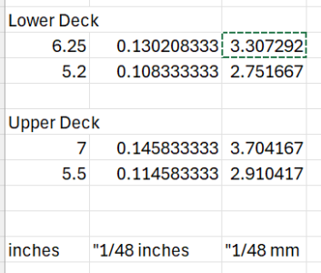

Not sure if you are asking the actual size or the scale size from others who building the kit. If you are looking for the actual sizes then want to scale them, the following are the scantlings for the carlings and ledges.
From the contract
Platforms
..............Carlings & Ledges of oak on the fore Platform & fir on the after Platform of the same scantlings &c the Lower deck
Lower Deck
To have 3 tier of fir Carlings on each side from the second room before the Main Hatch, to the second room abaft the main mast room, from thence forward & Abaft to have 2 tiers, the Carlings to be 6 ¼ ins broad, & 5½ ins deep, to be scored on upon the Beams 1⅛ ins aloft, & ¾ ins below, The ledges to be of fir 3¾ ins broad, & 3½ ins deep, to be placed not more the 12 ins, nor less than 9 ins asunder. All the Carlings & ledges from the fore hatch forward to be of oak
Upper Deck
To have 3 Tier of Oak Carlings on each side from the second room abaft the main mast room to the second room afore the main hatch, from thence forward to have 2 tier, & in wake of the forecastle to be of oak, the Carlings to be 7 ins broad, & 5½ ins deep; the ledges also to be oak in wake of the said forecastle & from the mizen mast aft to have half beams to be let into oak carlings of sufficient distance from the side to shift the knees, the half beams to be fir 7 ins broad, & 5 ins deep.
The contract also gives scantlings for the carlings of the mast partners and hatches, but at 1:160 the difference is negligible.

Actual scale size by calculation based on what Allen provided above:
I don't know what the model manufacturer provided. :)

Calings for Gun DEck are on F3 and are approx 4 x 4
But not sure about LOWER deck
Guss they are also 4 x 4

It looks like 3 x 2 BUT ARE THERE ENOUGH 2 x 3 for the MODEL?
Interestingly ALLEN says he would recommend cutting the slots as you FIT them and I am going to start that on the GUN deck with (i think 13 which is solid and work fore and aft )
