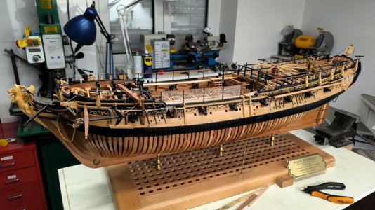

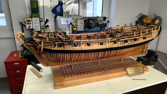

H.M.S. PEGASUS - Swan Class by David Antscherl & Greg Herbert Scale 1:36

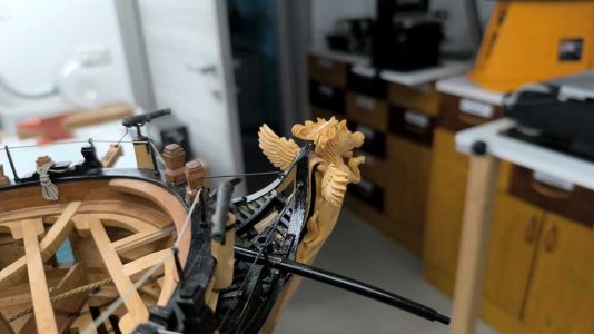

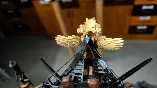

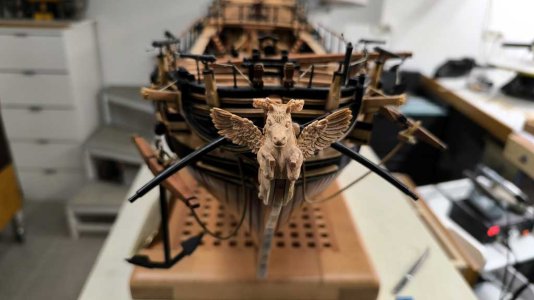

This is the cutest Pegasus I have ever seen! The new interpretation of the curly mane turned out to be unexpected. I think the curls were much thinner, because there is little hair in the mane. As in the photo:
1619751523_51-oir_mobi-p-griva-loshadi-zhivotnie-krasivo-foto-58.jpg 1619751423_8-oir_mobi-p-griva-loshadi-zhivotnie-krasivo-foto-8.jpg 1619751407_11-oir_mobi-p-griva-loshadi-zhivotnie-krasivo-foto-13.jpg 1619751496_54-oir_mobi-p-griva-loshadi-zhivotnie-krasivo-foto-62.jpg

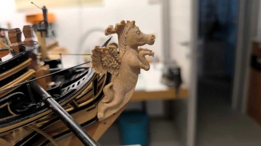

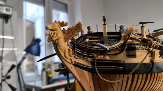

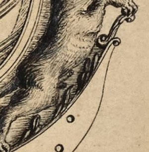

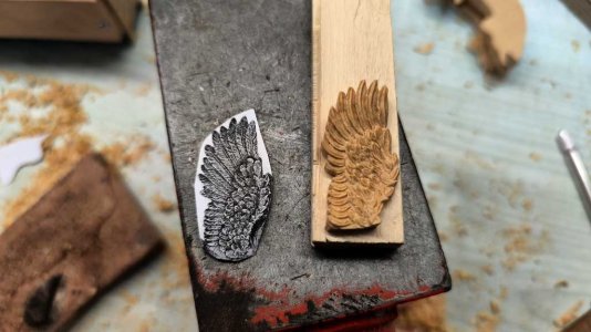

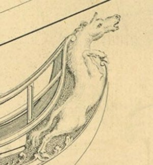

You have a small mistake. You made ribs in Pegasus's body. In fact, the image simply shows light and shadow with strokes.
Such strokes are often found in English drawings.
Horses were drawn without ribs in the drawings.
Moreover, Pegasus is the son of the main god, he did not starve.
If they wanted to draw a figure with ribs on a drawing, then this was depicted with special lines, like here:
But whatever you say, your Pegasus turned out very cute! :)

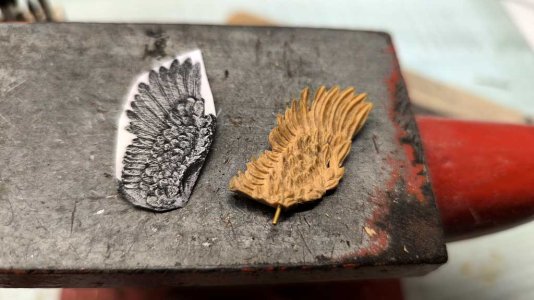

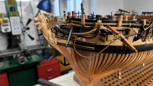

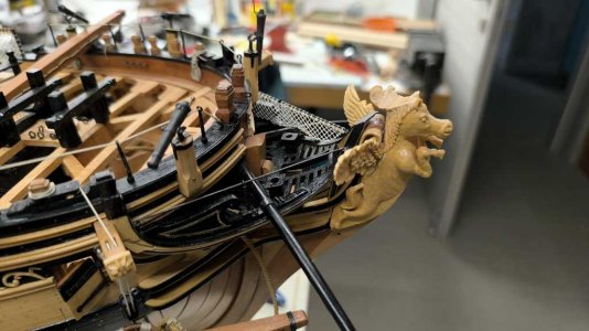

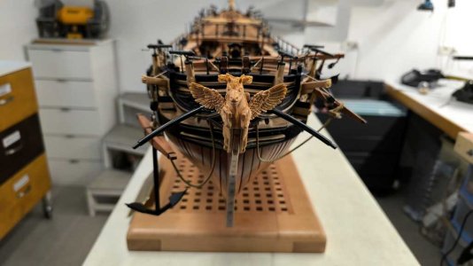

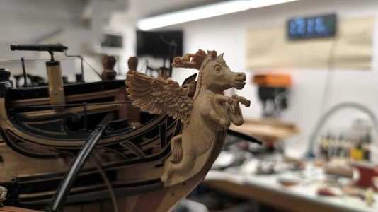

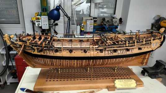

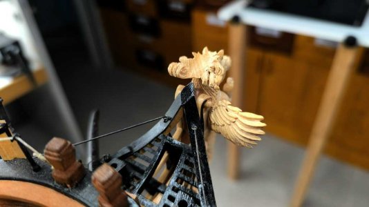

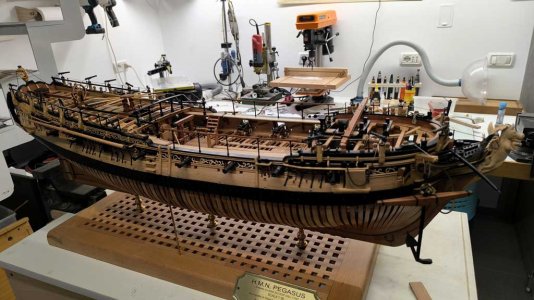

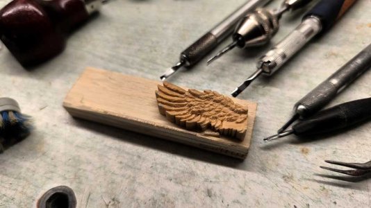

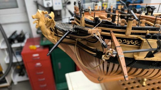

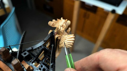

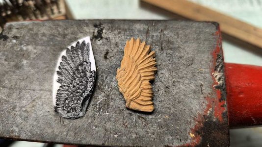

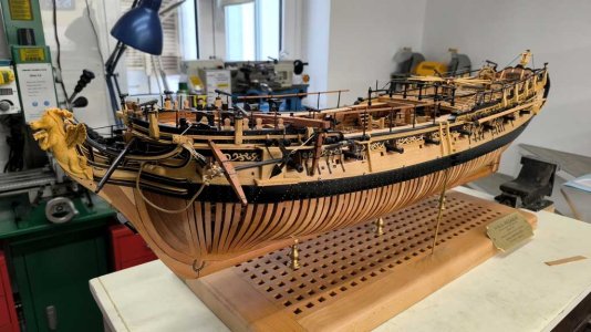

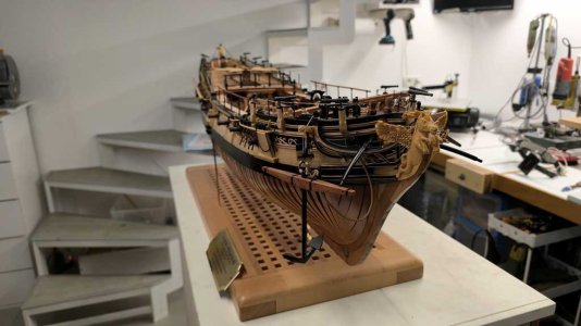

אחרי הפסקה, התחלתי להכין ולהקים את הבובה; הכל עדיין זמני, אני לא כל כך אוהב את זה, הייתי צריך להסיר כמה פרטים כדי לפנות מקום לחרטום, אבל אני ממשיך ואני מקווה שזה יהיה יותר ייצוגי.
View attachment 516130View attachment 516131View attachment 516132View attachment 516133View attachment 516134View attachment 516135View attachment 516136View attachment 516137View attachment 516138
wonderful carving work, my dear friend
Excellent work!! The detail is superb. Thanks for sharing these wonderful pictures and your carving talent!!!
We will be interested to see how you connect the wings. Just glue or some small pegs to reinforce the joint??
Love the model overall and I love the figurehead, especially with the details of the horse's body like the ribs. :)

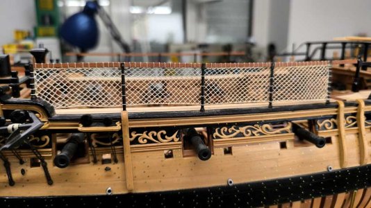

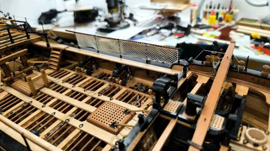

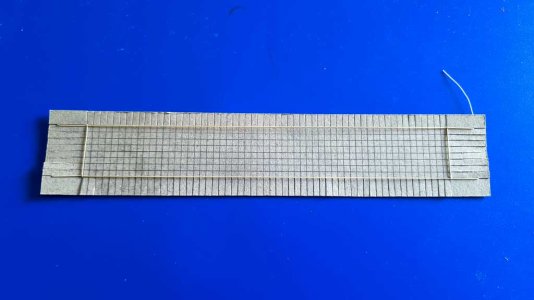

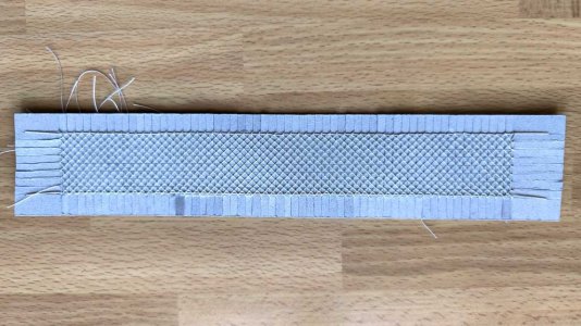

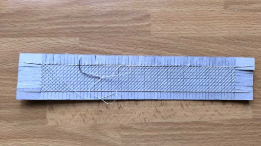

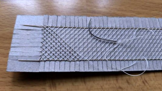

Last elements before starting with the masting: the nets of the gangways.
I used a cardboard holder of a suitable size, threading very thin cotton thread diagonally between the cuts and then using another thread in the opposite direction by tying knots in it
reti-01.jpgreti-02.jpgreti-03.jpgreti-04.jpgreti-05.jpgreti-07.jpgreti-08.jpgreti-09.jpgreti-10.jpgreti-11.jpg
View attachment 524428View attachment 524429View attachment 524430View attachment 524431View attachment 524432View attachment 524433View attachment 524434View attachment 524435View attachment 524436View attachment 524437
That's sick!
