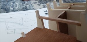

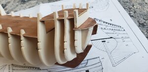

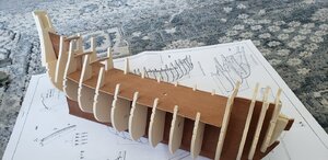

Got the bulkhead frames assembled and the few crossbeams made for the foc'sle, quarterdeck and poop. Also added the hawse pieces (bow filler blocks) and did a bit of fairing. I'm loving the multiple decks and the pitch on stern decks.
Not sure why, but rounding and fitting those cross beams into place was sooo incredibly satisfying. I'm sensing a fully framed ships in the near future

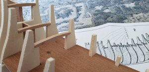

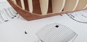

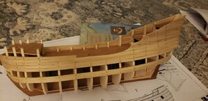

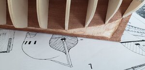

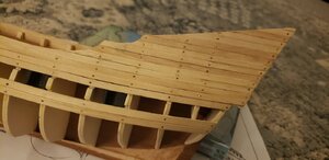

All false decks are in place, and frames are faired. My new cordless Dremel Micro made easy work of fairing.

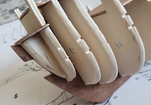

I'm still considering whether or not I should cut a rabbet here. Instructions do not call for it, but I think I would like to -- I am just really nervous to go hacking at my keel.
Otherwise, I'm ready for the first layer of planking. This first layer is of beechwood, as were the cross beams above. I love the feel and workability of the beech and this is the nicest wood I've seen in a kit--of course, this is only my second build, so take that for what it's worth.

Hi Eric, looking good. I would certainly cut the rabbet if I had the choice as it will make much for a much cleaner joint at the bottom of the keel.

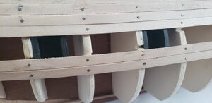

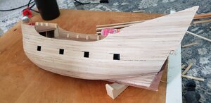

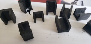

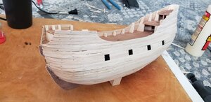

I decided to try dying the cannon holes for the gundeck openings using black india ink. (Speedball Super Black India Ink) I came across this in a discussion of ebonizing wood. I'm also planning to use this on wales, etc in the future.
This structure is a box that sits behind the planking for mounting lower deck guns without actually building out a gun deck.
I'm pleased with the result.

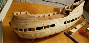

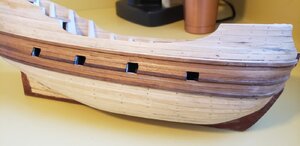

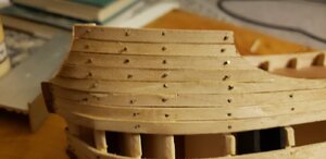

Made progress on the first layer of planking up to the gunwales, with significant shaping of the planking at the upper stern this morning. I think those curves are going to look really nice with some smooth, polished gunwales once those are installed. Going to need to do some serious plank steaming/bending to finish the focsle and lower planking, but I'm surprised how much smoother this is going on my second build. I guess I am teachable.

It looks very good Eric! The ship has beautiful lines, indeed. I just love those tall, narrow stern and the upswept forecastle.

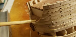

Jul 9, 2019
438
323
I agree, @Heinrich , I love these decks and the lines of both bow and stern.

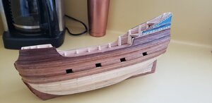

Today I managed to finish the 1st planking at the focsle--talk about lines... :) I love the curves where the focsle planking meets the bowsprit.
@Maarten , Does that part have a name?--that is, the foremost portion of I suppose what would be the weather deck?
I also managed to finish a little more of the lower planking to just below the waterline.

Eric. The correct terminology is the "luizenplecht" in Dutch - the only place on the ship where the crew would be out of sight of the officers - so a place where they could take things slightly more easy. "Lui" translated directly means "lazy". No wonder that the seats of ease were close by. :D
Fully correct Heinrich, nothing to add to your Dutch. :).

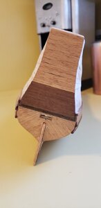

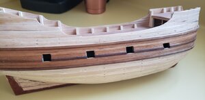

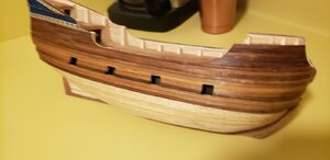

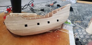

And upper hull planking is done. Now my least favorite, the lower hull. The lower hull is supposed to be done in tanganyika, but I'm not crazy about that coloration. Any reason (historical or otherwise) to stick to this, or is doing the whole thing in walnut a good option?
Jul 9, 2019
438
323
Quick question of advice for folks from a noob -- I'm kind of unhappy with the inconsistency of the walnut planking here. Would it be worthwhile to hit the upper hull planking with a dark walnut stain to get the coloration a bit more consistent, or will the underlying color of the wood make the stained version just as inconsistent?
