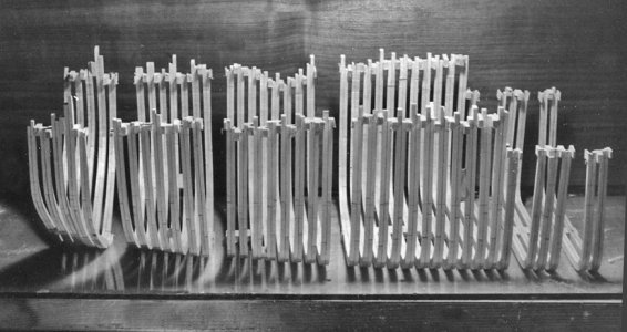

I started out by plotting both faces of every frame. That takes forever. After a long evolution of development, I just trace the station shapes from the body plan, set the moulded dimension, determine the butt lines for the timbers and isolate the individual timber patterns. I can loft a first rate in about 10-14 days. I am just wondering if 3DCAD can match that - once the lines from the plan is entered as program lines.

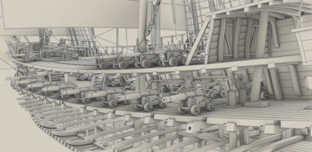

At the same time, I will also give another example, presenting somewhat different approach, supplemented by the possibilities offered by today's 3D software. Some time ago, I designed a ship from a bygone era digitally, yet strictly based on historical source data, including the geometric method of obtaining hull shapes used at the time. In this sense, 3D software was just a tool like any other, but importantly, it also guaranteed a level of precision that was unattainable with traditional methods, as well as the ability to simulate many possible variants, still before cutting (and possibly wasting) wood. Of course, this is only possible with the adequate level of skill, diligence and competence in the relevant fields, both in terms of historical knowledge and the use of the tools themselves, which is not always the case.
Below are a few renders of my design:
Indeed, after converting the 3D model into 2D drawings and handing this project over to professional model makers from the museum workshop (they eventually opted for the POB method and a scale of 1:15), they commented that this was the first time they had worked on a project where everything fit together perfectly right away. They cut the bulkheads on a CNC milling machine and practically all that remained was bevelling (no fairing needed as is usual in model making based on less than perfect documentation).

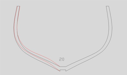

Attempts to extrapolate personal experiences based solely on one's own DIY experiments are very risky and can prove to be very misleading. In the context of so-called scholarly research, or at least that conducted by members of this community, perhaps the most spectacular disaster was the fabricated idea of building ships by eye, with the following justification: ‘since I have managed to build a model by eye, real ships must also have been built by eye several centuries ago, and not in some conceptual way’. Now it seems unbelievable, but this idea of intuitive building was widely and uncritically accepted by probably the entire scholar community, despite its obvious logical flaws and without any further verification.
A good, concrete example is the method of achieving bevelling you employ, i.e. using battens, which by necessity can only be applied after the frames have been assembled in the hull skeleton. Indeed, it is tempting to extrapolate this way to historical practices used on a real scale. However, it turns out that methods for obtaining bevelling have been described, sometimes in great detail, since at least the beginning of the 17th century, and refer to a process performed even before the installation of the frames, so necessarily without the possibility of using battens.

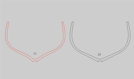

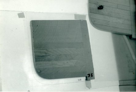

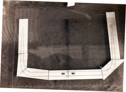

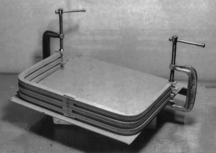

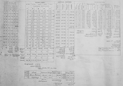

The idea HMH (Harold Maxwell Hahn) had was to create a system for model ship builders to scratch build plank on frame models. Those who can do it and those accomplished in CAD and 3D modeling is to make it understandable and possible and raise the hobby of assembling a kit to a finer level of building. Hand this to a hobby kit builder and ask them to build this hull, 99.9% would have no idea what you're asking or what this is. Using the K.I.S.S. method is the mission

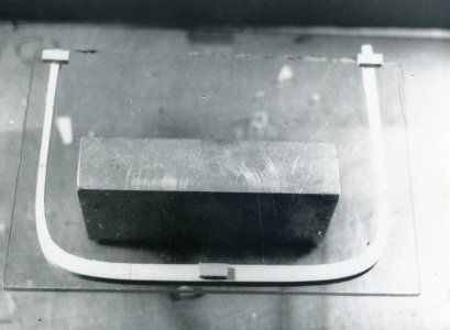

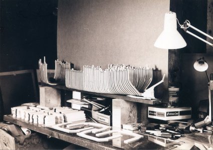

i watched Bob in his micro mold loft making patterns as he built his models and i watched HMH take months drawing and redrawing refining modeling plans. I thought geese that is a lot of drafting going on there must be a simple way. I thought there isn't that many hobby guys who can do such drafting of frames. One of my first plank on frame models was the ARGO the last wooded freighter built on the Great Lakes. What i did was build a half model of the hull and sliced it into frame templates.

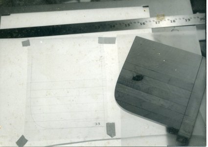

Then i took the template and traced it on paper
Using HMH frame blank idea
each frame blank was built
and the frame cut out

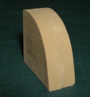

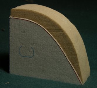

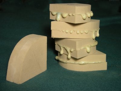

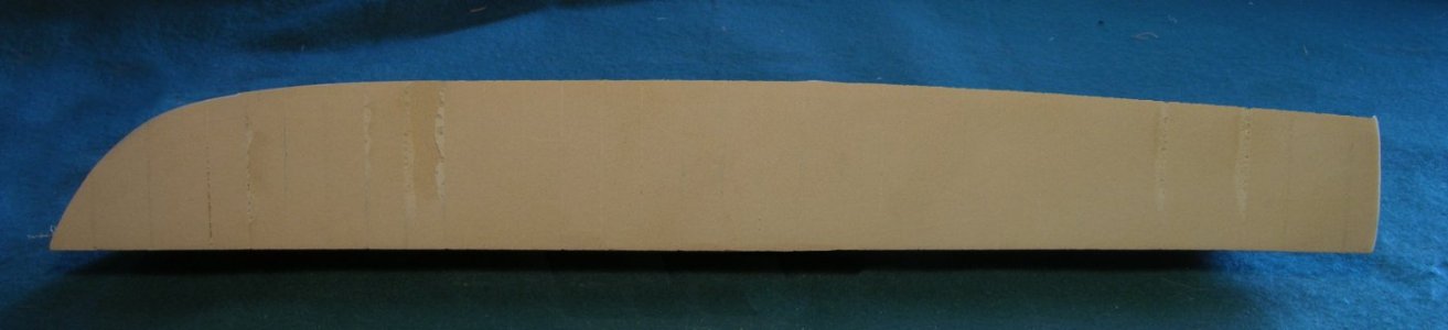

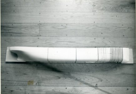

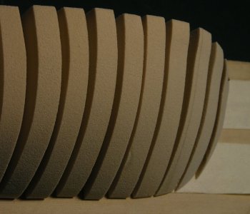

Years later and seeing the merits in using a jig i refined the half hull idea. Still trying to make getting out frame shapes as simple as possible. starting with the bobyplan

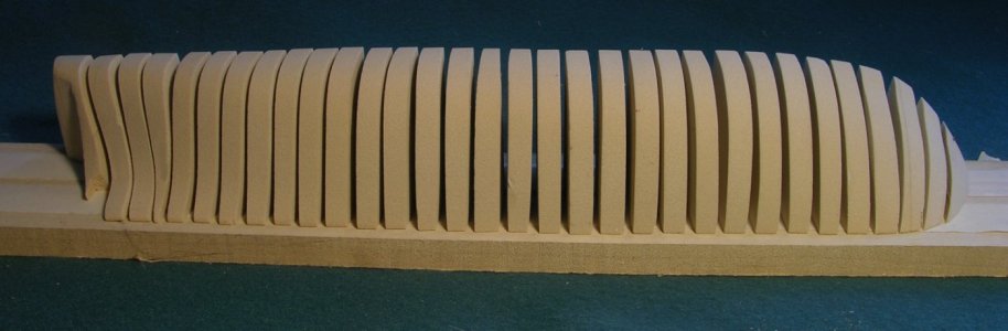

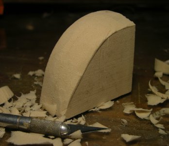

using a dense foam material i cut out a station section

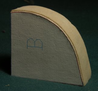

glued the station pattern to one side and the station pattern to the other side

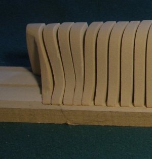

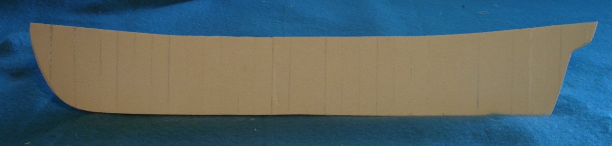

shaped it from station line to station line

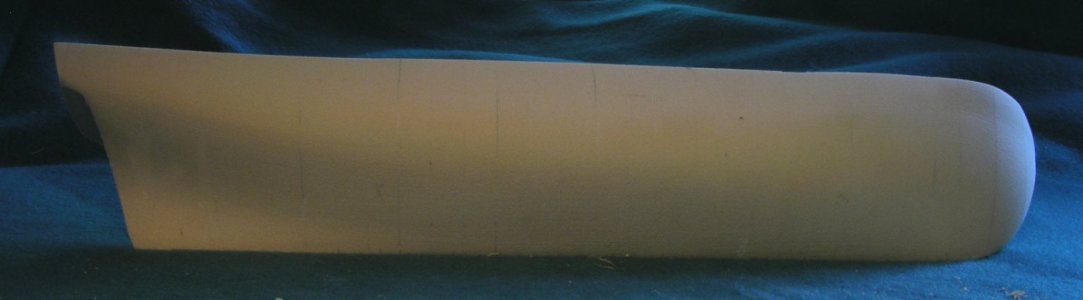

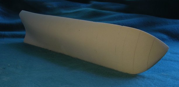

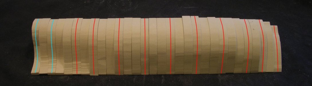

you can get a refined hull shape so much closed with a half hull than drawing out frame by frame. Keep an eye on the hull taking shape

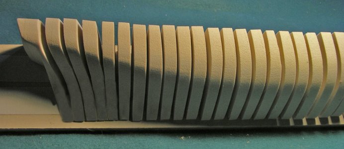

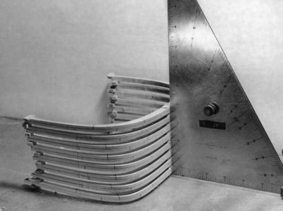

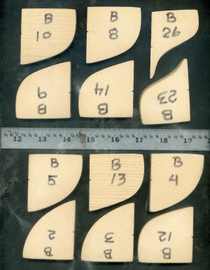

when the hull is finished i cut it into the frame patterns
the bevels are included

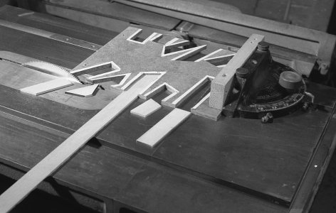

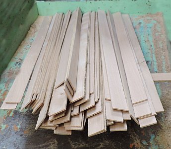

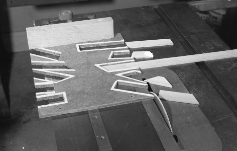

To build the frame blanks you will need 120 linear feet for the schooners and 225 liners feet for the larger models. To cut the framing stock you start with 4/4 lumber that is 1-inch-thick lumber then thickness sand it to the correct size. The smaller size table saws say they can cut up to 1-inch-thick lumber but that might be pushing the machine to its limits. A full size table saw might work better.
Then the accuracy and finish of the cut might be an issue. Personally, i rip the framing stock on a bandsaw and run it through a thickness sander.

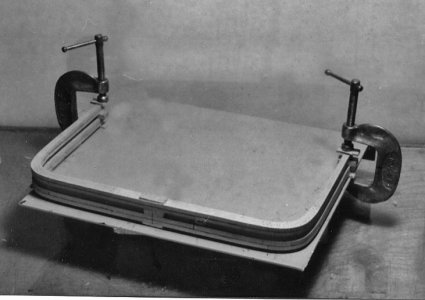

Once you have the framing stock it is all about cutting the stock into pieces for building up the blank. On every plan there is a drawing of the frame blank and the amount and angles for the pieces.

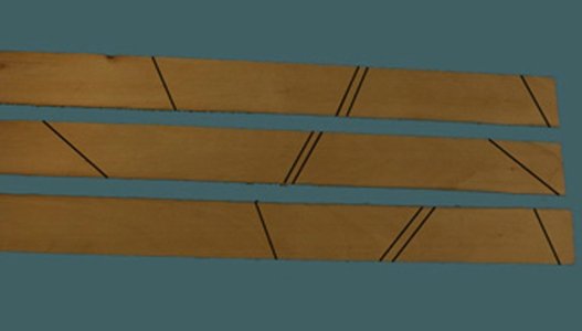

let's do a little math on an average it takes 9 pieces to make up a blank and each end of each piece is cut on an angle. your making 18 angle cuts per blank. In this model of the Hancock there are 66 frame blanks to make so you're looking at around 1,000 angle cuts. To frame a model in a jig requires building the blanks in a jig which requires cutting the pieces of the blanks in a jig.

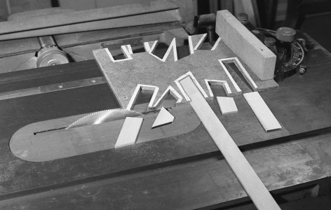

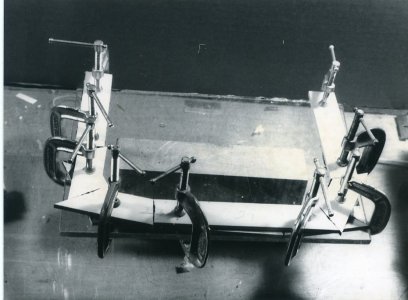

HMH solved the problem with a jig to make sure each angle is cut perfect. One issue with this is the material has to be a consistent 1 inch and rough 4/4 lumber is not always the same thickness it might range from 7/8 to 1 1/8. To use this method you have to buy 5/4 lumber and plain it down to 1 inch or buy 8/4 lumber rip it down into 1 x 2s and then rip the 2 inch into the framing stock.

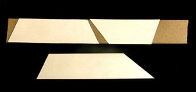

The freehand method for cutting frame blank pieces
you are going to need power tools to build from the HMH method. a scroll saw or band saw and a disk sander if you purchase framing stock that is cut and sanded to the correct dimensions. If you cutting your own framing stock then you need a thickness sander.

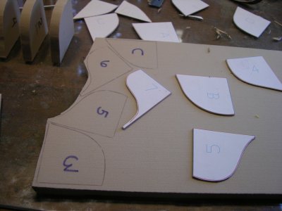

first thing to do is make copies of the blank as drawn on the plans, thane those drawings and rubber cement them to a piece of cardboard. You want a nice stiff template to trace from.
now trace the patterns on the framing stock
