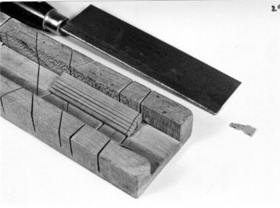

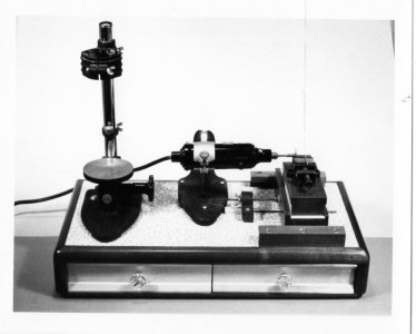

In order to build the models following the plans as is or altered, you need tools. Many builders were kit builders wanting to expand their knowledge and building better models. The problem was they did not have the power tools to rip down lumber and mill it to scale dimensions. To fill this gap the "timbering set" was invented.

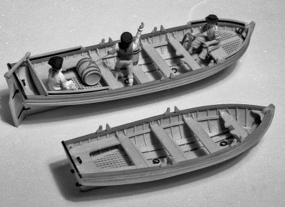

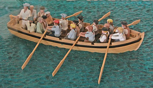

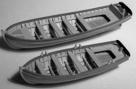

I believe that the first picture that Dave posted is from Hahn’s Colonial Shipyard Diorama. If that’s correct, the scale is 1:96. How many ship model builders could scratch build the small boat and crew to that scale?
