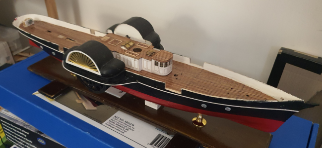

Central structure progressing, I intend to put lights inside the structure but I have found with the thinner woods, the light shines through. this may not be a problem when covered by paper but to be sure, I have painted the insides of the thinner woods black
Well I have emailed ModelExpo about the missing parts, Let us see what they do, This happened previousely with the Endurance and the Company quietley sent me the replacement parts (no Charge)
Now I am doing the fiddley bits that need a steady hand (which I do not have). still progressing slowly. I am about to attach the outside walls with a contact glue & I am not sure how that is going to go. I should also say that the hatch cover at the rear is not really a hatch cover but a switch to turn the wheel motors on and off. Pess once - they operate, press again -they stop (I hope)
I have installed the steering Mechanism & checked it out - It works, I will remove the rudder for the time being because history has shown it is easy to damage during future handling. The Mechanism is fixed permanently
I now test fit the pieces more often because I have found things that need to be done before glueing. In this case it is the stays underneath the pontoon. they have to be moved away from the wheels as they could interfere. I have done this. the move was only 2mm but It had to be done because of the position of my wheels and kits fake wheels differ slightly
