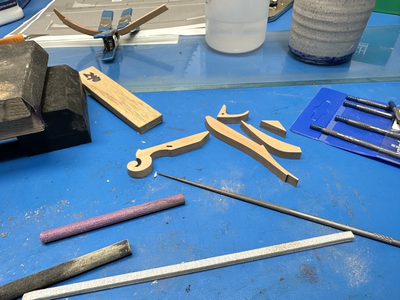

I cleaned up the parts for the bow. They look great but I made a mistake. In my jeal to remove char, I probably oversanded/filed, especially on the decorative piece. It's a shame, but it doesn't fit together air-tight anymore. I did my best and used a little filler made from cherry saw dust when I finally assembled it. It doesn't look so bad, but total rookie mistake.
In my defense, and as an overall comment, the wood does seem a little scorched and the cuts are less than smooth. You'll want to do a lot of careful finishing. But the quality of the wood is such that it's worth it. If you make it to 240 grit, you'll get a nice luster and my color tone on the cherry is medium. I'm sure it will vary from kit to kit, but I wasn't taken by surprise.

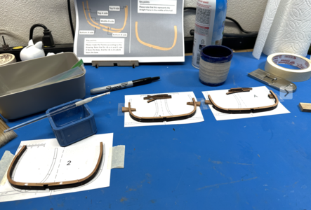

This leads to the frames. The parts for each frame are three different thicknesses. It's easy to follow once you figure out which part carriers have what. I made copies of all the frames drawings and cut one out per frame to use as a template for each frame assembly. I removed char from the ends but left the char on the side in anticipation of sanding things flush and to a bevel.
I think the template is a good practice but it lead to a bit of a deception. I don't know if I was eyeballing parts onto the template wrong, but I got several a bit cock-eyed. This led to some painful disassenbly (Titebond Quick & Tight seems to be more stubborn about de-bonding than other PVA glues I've used). Also, I ended up carrying some forward and it led to disaster, but that's later.
I found assembling 3-4 at the same time was about right. By the time you cycled through each part for each frame, the adhesive was sufficiently bound to be stable.
The key here is to STAY ORGANIZED. The parts aren't marked unless you mark them so keep everything segregated or just do one frame at a time. Fortunately, I stayed organized. I had 4 Ziploc bags that I marked with frame numbers using a Sharpie, deposited the pieces I cut out, and then laid out the individual frames on the templates that I taped to the workspace. After assembly I reused the bags after re-marking. I'm sure you have your own way to do it, but just be careful if you want to do more than one at a time. Oh, and don't forget to mark the assembled frames.
I show the frame assembly using pieces of the part carrier with different thicknesses to hold the frame straight to dry on the template. In retrospect, I wouldn't recommend it. It lead to some tilting into the plane and it turns out it's just not necessary. If you squeeze the parts together really hard until they are cold-welded together and then position them, you can just wait 30-60 seconds before you put them down without the spacers. I think it made for a better joint as well. If very little glue squeezes out, I would pull it apart and add more before trying again. Of course, be mindful of extra glue sticking out. It will gum up your sandpaper later if you don't clean up now.

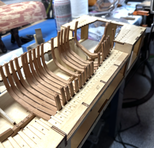

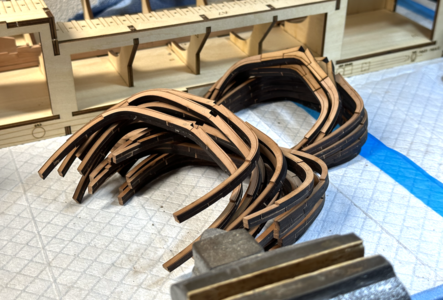

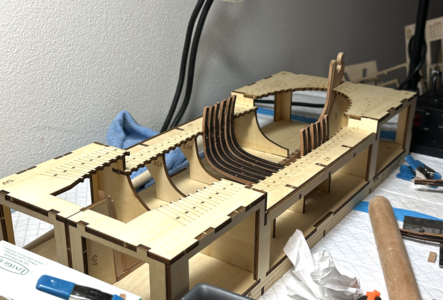

Here is a first wave of frames going into the building jig.
I had problems fitting into the keel. After trying to get the frames between the spacers, for some reason I decided to use a chisel to neatly cut away a little of the spacer and squeeze in the frame. Jump ahead to the future and I will find out some frames are just too thick for their space on the keel. On the half frames, where you can't just cut away the spacers, some parts were too thick and had to be sanded quite a bit for thickness before they dropped in neatly, especially at the bow. I have a feeling I am going to pay a price in the future for my promiscuity with the chisel.

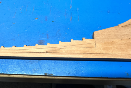

I forgot to mention about the false keel. No parts in the box. My guess is that shipping replacement parts from China would be prohibitive so I sought some online. I won't mention the vendor, but it turned out to be harder and longer than getting them from China. I should have asked, Dry Dock Models and Parts have been really good to me. I am still assembling frames with no false keel, but the space was pretty small (2mm), and in actual construction it was fastened later anyway.

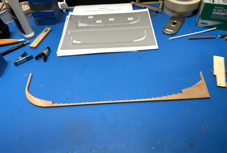

Here's a shot I forgot to post earlier of the keel assembly. I was contemplating getting the tarred flannel look. To that end, I got the loose char off but left the darkened wood, assuming it would give good adhesion (which it did). I think it looks pretty good. It might have been better with some pigment mixed into the glue, but it's a start. Boy, do I wish I had left the dark wood on the pieces of the bow, it would have fit together better and looked sweet.
I stopped because I didn't know exactly what joints were treated this way and which weren't. Also, the rising deadwood is modelled as a single piece, so already missing some detail. In retrospect and looking at this picture, I wish I had done a little research. But this is my first POF. I will focus primarily on the assembly and the quality of the finish on the wood. Next time, I'll experiment more with tarred flannel simulation and do my homework.
I wish I had done it, but glad I didn't let my perfectionism get in the way of getting something done. Live and learn.

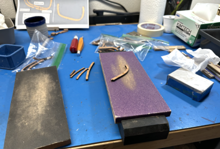

I started cleaning up frames. I used a disc sander for the outside as much as I could and a Dremel for the inside.
The hand-held Dremel was a disaster. It lead to all sorts of chaos: erratic edges, thin spots, unwanted bevels, and boo-boos of various kinds. I reduced the grit from 120 to 400 and it helped, but it was still a bit erratic. I ruined frames, 0, 2, 3 B, and C right from the get-go with frame 0 being the worse. That frame was so far gone that I would have never gotten a fair looking clamp in there.
I was ready to give up. I could try to fair the inside of the frames, despite the instructions recommending against it (and then suggesting it again later). But the difference in thickness was too much I thought, it would be too much thinning and work to get a smooth run. I decided to give up.

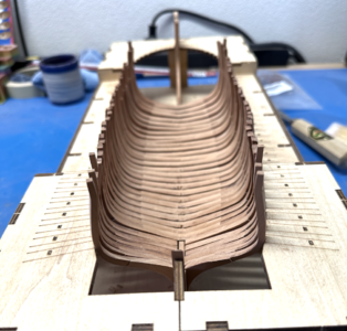

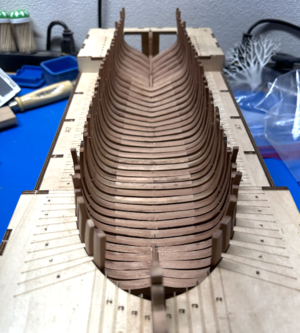

I completed the aft half frames. It was a bit tricky getting the angle to mate to the keel right, or at least for a beginner. I am a little off on several but nothing some extra glue and a keelson wouldn't cover up. Except for frame 18. I really made a mess of that one. In trying to correct it, I ended up changing the angle on the surface in a way that makes it tilt more outboard as well. What a mess. I'm going to have to cut a new one. You can see it in the bottom right with a good gap between it and the full frame in front of it. I thought about cutting a wedge and gluing it on, but the angle is so complex, it's just not going to look good. Plus, I am already firing up the laser cutter for the other frames.
I finally got closer on the angles for mating the half frames to the keel. The bevels included just aren't on the money, as you might expect, especially for the shallow angles. I used a protractor between keel and marking on the jig for the frame and then put that angle on the tilting table on my disc sander. Yes, it's a nice thing to have, not a necessity, but I'm not sure I could reliably get closer to the right angle. The fore half frames look pretty good. Here's all the frames on the keel, not affixed.
Now that I've assembled, shaped, and fitted all the frames, it looks like I have 2 full and one half frame I must redo. There are another 3 dodgy full frames I'd like to retry as well.

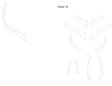

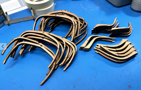

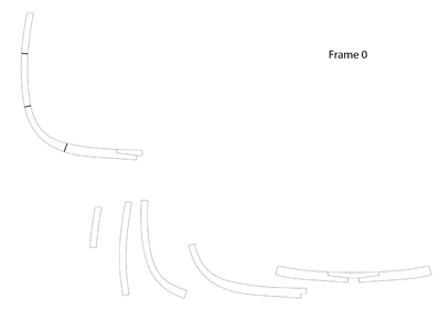

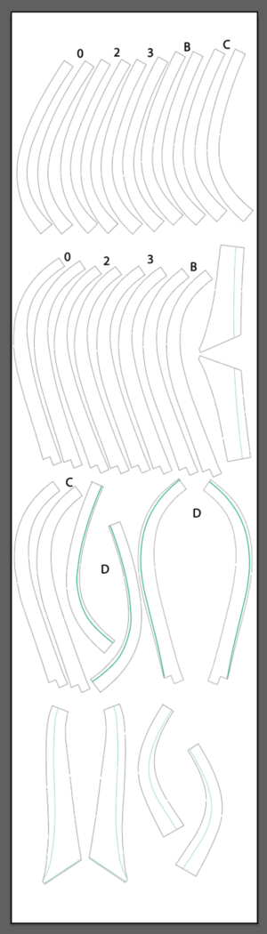

Here are two of the frames traced in Illustrator onto scans of the frames from the documentation. Each is broken into components. Don't forget, 2 ea of 4 of the 5 pieces of the full frames.

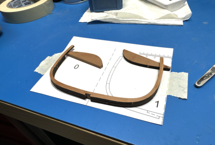

The beveled frames are harder. It takes some real concentration to keep the bevel engraving right for the different pieces. It was nice to have the failed frame for reference. Here's the highly beveled frame 18. Note that for the over all outline, you have to extend the back portion to the full length of the front portion in order to capture the bevel. If you just trace what's there, you won't have enough material for the bevel. You'll see what I mean if you try to do this, just telling you so you don't think you are crazy. The drawings in the documentation are for finished frames, not what you need to cut out exactly. Here's frame 18.
I ordered the different thicknesses (1/8", 5/32", 3/16") from the Lumberyard, ordered 3 3"x24 of the first two sizes and 3 2"x24" of the 3/16" material. I didn't want to order and wait again. No matter how fast people send stuff, it's always too long when you are waiting for the next step. Fortunately, all the drawing took up some of that time. Here's another Illustrator file with all the paths for the parts.
