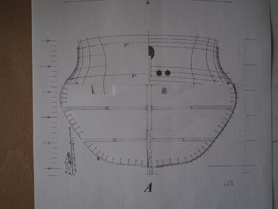

thanks, Thomas, for the diagram of the bulkheads but I wouldn't know how to scale it up or down to copy or trace them

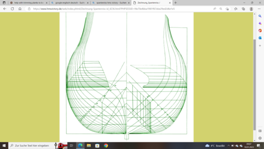

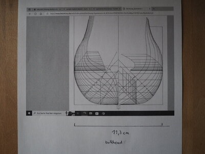

This is what the drawing looks like when I print it out (11,3 centimeters wide). You must measure the widest bulkhead without planking of your model and adapt the drawing to your model by scaling it with photocopies.

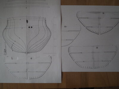

Here is a personal test of a model, whether the delivered bulkheads of a kit correspond to the scaled construction drawing. Here you can see the first eight bow bulkheads on the drawing.
By placing the photocopied bulkheads on the original drawings, the dimencional accuracy can be checked.
If a copy of the bulkheads drawing of the Victory is available in the correct scale, you can check your bulkheads this way. Because the drawing has more bulkheads than your model, you must use the closest bulkhead.

You obviously have the build/instruction manual. That manual appears to have drawings of the bulkheads for ID purposes. Copy and trace those via either home printer or have a good print shop do them. You can then scale them to proper size using other known or personally scaled via your own ruler. Or a print shop can do the job provided you give them the correct scale. Cut new. partial bulkheads from plywood, glue in place then replank. I believe this is about what what Philski was suggesting. Last recourse, - start over with a new kit and chalk this up as an expensive mistake, especially since you trashed the original laser pattern panels
The original bulkhead profile might be traced from the holes in the the sheets from which they were cut - if that was their origin and you still have the bits.
