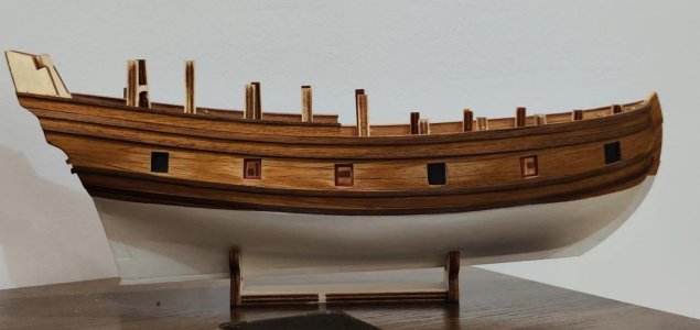

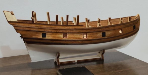

Heinrich my friend, your gunports are looking very good right now, but did you check the height of the ports with a kanon before cutting ??
Because maiby it is because of the foto ( or my eyes ) but it looks to me that the gunports don't follow the curvature of the dek??
You have made a very good observation my friend! The gunports do not follow the deck line - especially at the bow and at the stern. The other issue is that the gunports sit too high in relation to the deck. I will have to add filler pieces to the bottoms of the carriages to lift them higher so that the cannons will be in the correct position (I won't even install wheels on the carriages, because they will be off the deck once the filler pieces are added to the undersides of the carriages. That is why I need to remind everyone that this kit was never intended to have cannons fitted - so everything I am doing now is scratch-building, together with all the headaches associated with it.
:eek: That is exacting work. I think you are to hard on yourself because those gunport look great. I would think once the ports are covered the they will look even better.
I hope you are right, Jan! Normally when I finish a section of work and post pictures, I am confident that it is right and look good. Tonight, there is just no way to tell if this was a good job or not. Also bear in mind that I intend to leave some gunports open for the installation of cannons, so they have to be accurate.

Regarding the template one remark. If you use the side view 2D drawing and use this as a template in a 3d plane, like the side of your hull, the positions of the gun ports will move due to the curvature of the hull.
This will mainly affect the bow chase port.
See attached a research paper on Scheurak 01, if you didn t had it yet :-).
Thank you so much for your very kind comments, Maarten. I hold your opinion in very high esteem - so, thank you! The oak/CLOU combination (something I have you to thank for) looks really good and I try my utmost to work as clean as I can.
You are right about the hazard of using a 2D drawing in 3D conditions. What is a nice little aid on the sides of the hull, becomes evil personified around the bow. :mad:

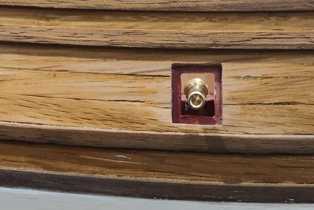

Hello Dear Friends
After three days of painstakingly working on the Starboard side gunports, I have something to show. The three ports that will remain open and receive cannons, have received their inner frames which have been painted in "Karmozijn" red - a very dark, almost purplish red - and the closed ports have received their inner backing. Originally, I wanted to leave the gunport closest to the stern open, but that would have been incorrect. The two most rearward cannons did double duty: they were either placed in the position of the two most rearward ports, or, if the ship was being chased, they would be turned around and placed in the two stern ports. Seeing that I have already mounted the two cannons in the stern, placing a further two in the two most rearward gunports on the sides, would have been incorrect.
I am now in the process of assembling a cannon and carriage which I can use for determining final mounting heights and angles.

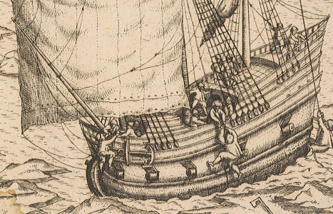

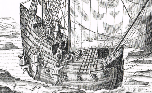

Daniel, that is such a valid point you are making about the gunports following the deck line or the wales and not necessarily sitting perpendicular to the water line. On all three the plans that I have of the WB, the gunports are perpendicular - it may be correct, but it "looks" wrong. If you have eaten, drank and slept a ship for as long as I have the WB, and if you have studied the De Veer drawings as extensively as I did, you start getting a feel for the lines of the ship and you realize, that those are the lines that the artist tried to portray in his drawings. And that is exactly what I am trying to do with this build. When I look at the model, I want to get the same impression as when I look at De Veer's original drawings.
Een though these two drawings are different, they are also remarkably the same. The way in which the gunports are portrayed, are vastly different from how they are drawn on the plans. I do not doubt the plans for a moment - I'm just saying that I prefer the look in these two drawings! OK, now I can be officially placed in one of those long, white jackets! ROTF
Well, ROTFthere have certainly been times in my build that a white jacket would have been more comfortable than the seemingly impossible decisions one must make in order to keep moving ahead.
