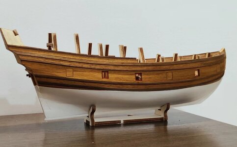

Hello Dear Friends
Afte exactly one week of work, the gunports on the Starboard Side are finished.
Tonight, I had a female colleague over who had never in her life seen a model ship. I showed her the Sampan, the Batavia, Willem Barentsz #1 and WB#2. She barely afforded the other models a second glance - she just had eyes for WB#2 enthusing about the "striking contrast of the wood-color and white waterline and the karmozijn of the gunport frames. :)
The challenge is now to repeat this exercise on this Port Side.

Thats because you "owned it" Heinrich.
A lady who obviously recognises quality work even though she is viewing ship models for the first time.
Great job on those gun ports Heinrich.

She is looking great Heinrich, i wish you a lot of succes and fun with the other side :) :)

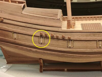

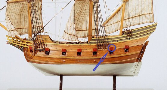

Just when I think I have made progress, the little ship bites. This is what happens when you take your eye off the ball for a split second.

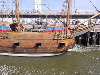

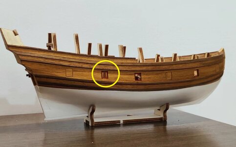

Take note of the position of the gunport second last from the stern. Now compare it to WB #1
On WB#1 there is no problem, because the gunport lid is closed. On WB#2 however, the open gunport lid will foul the deadeyes. :eek: And what is really frustrating is that there is no excuse for this blunder. I had WB#1 two meters away from where I worked, so checking that was the easiest thing in the world.
The only solution will be to close up the offending gunport and open the one most rearward (which will be strictly incorrect as I already have the two cannons mounted in the stern!)

Open that lid 90 degrees, it doesn't have to be open almost 180 degrees. In fact, you could open all of them 90 degrees ;)
I would say, place your deadeyes, and then check how far you can open your gunportlids, before making a drastic dicission Heinrich.
If you are not satisfied, then you can always alter something in your kanon placement.
