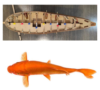

By the way, it just struck me how the hull looks remarkably like the body of a fish. Can't be coincidental.
(The goldfish picture is not mine, so I won't take credit for it.)
Thank you, Johan. I am sure the goldfish-shape was no coincidence. With the advent of the 17th century all Dutch ships were built with a specific purpose in mind - be it cargo ships (like the Fluyt), merchantmen (like the VOC ships) or men-o-war. The WB and the Geunieerde Provincien were probably some of the last well-known ships which were built without these encumbrances. With their sailing characteristics as the prime objective, the goldfish analogy therefore makes sense!

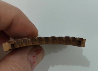

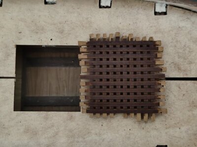

I started with the gratings and even though this is always a finnicky part of the build, this went very well. Here it is shown assembled, just prior to gluing.
Even the required curvature was achieved without sanding. Sanding will of course take place, but that will be for finishing, not for creating the curvature.

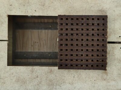

Cut to the correct size (no sanding yet) and ready to have the frame installed. In the past (and on WB#1) I have always mitered the frame joints, but on the WB that is incorrect. The frame needs to be created from half-lap joints. Before I tried my hand at doing that on the main hatch, I first practised by making the smaller, rear hatch.

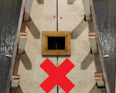

Clearly that hatch will never be allowed to see the light of the day, so a re-do is required. The problem though is that in cutting the 1.5mm x 4mm planks for the hatch, this happened!
If you have thought that I have exaggerated in the past about how tough oak is to cut, here is the proof. And as my dear friend, Mr Murphy would have it, I have plenty of blades, but no more knives! Ah well, sit back and relax.

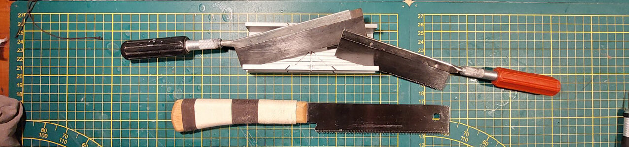

Can your very fine back saw do you any good in this area?
Murphy was, is and always will be lurking around, waiting for the most inopportune moment to strike and to strike without mercy. I honestly cannot say he or she is a great friend of mine.
Your grating looks great by the way, but frankly, I don't expect anything less...

Thank you very much Johan. The grating came out very well, the rear hatch not so well. It would have been so much easier just to miter the joints at 45 degrees. :eek:
These ships where always a bit on the rough side my friend, when they build ships in 1600, they did not spend much sandpaper on them.
Cutting your oak planking goes perhaps a bit better with a blade like this:View attachment 327887
That blade is a very good suggestion, Peter! Whether I can find it in China though is a different story :)
@Steef66 Thanks for the tip my friend. My challenge is that half the time I do not have any idea how to find the tools in China. Everything here is on Taobao and navigating that without Chinese is like looking for a needle in a haystack.
Je hebt al een paar suggesties gehad Heinrich, maar hier doe ik het al jaren mee...
Alvast bedankt Piet. Deze zou ik op Taobao moeten kunnen vinden. Met WB #2 heb ik de Japanse zaag bij Hans besteld wat briljant is maar voor dit soort zagen zijn de tanden te grof. Ik zal morgen een plan maken. Gelukkig voor de rest van de huidbeplanking kan ik mijn zijsnijder en vijlen gebruiken.
Thank you, Piet. These i should be able to find on Taobao. I ordered the Japanese saw from Hans with WB#2, but the teeth are too coarse for this type of very fine cutting. I will see what I can find tomorrow. As far as the rest of the hull planking goes, I can use my side cutter and files.

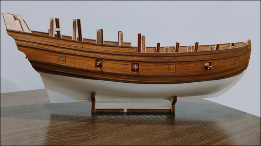

Hi Heinrich.
Your WB with both closed and open gunport looks very nice. It gives a nice personal touch.
Maybe a small visual cosmetic addition: let the plank seams continue over the shutters? Now they give a break from those nice curved lines.
I took the liberty of adding those lines to a photo of you in Photoshop to show what I mean:
I know you are skilled with the sharp blade. With a few minor scratches.... :)
