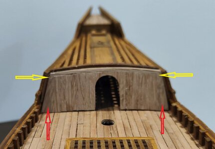

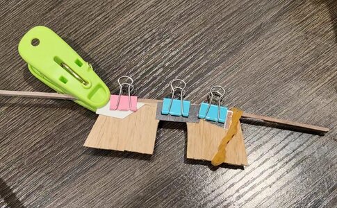

Tonight, I will take you on a rare and gruesome (at times) tour of the construction process of the front wall. I have said many times that I build in an unconventional way and without any precision tools, the steps taken are sometimes rare and cringe-worthy at times to say the least. Now bear in mind that at this stage I still have no idea whether this effort will be successful or not. I think there is hope, but in this game, you never can tell until the last moment.
I started off by cutting out a rough template from the deck sheet of the kit. Because of the extremely narrow part that is left above the arch the whole thing is super flimsy and just wanted to collapse. A crossbeam was tacked in place with PVA to hold the assembly secure while I positioned it correctly.
After about 15 minutes the crossbeam was secure enough that I could remove the wall from the ship, glue in a substantial and permanent crossbeam at the rear of the wall and remove the temporary one placed at the front. If it looks terrible, it is because it was terrible-looking - cringe-worthy I tell you.
As the rear supporting brace was drying, the connecting piece above the arch was removed as it was too damaged to play any further role in the construction.
It was subsequently replaced by an equally rough-cut door template which was glued into the rear supporting brace.
The door [posts were glued to the template in their correct positions and the planking started. This version saw the third planking variation in my efforts - vertically as per Ab's plans. Clearly the overlapping planks and the horizontally placed ones did the assembly no justice, so attempt #5 saw vertical planking being employed.
With a fair bit of planking done around the door arch area, a pilot hole was drilled and enlarged with round files to give me an idea of the door arch positioning.
And then I got really busy and forgot to take some vital pictures. In a nutshell, the rest of the planking was completed sands a few corner pieces (the opening which is to become the arch was also planked over). The top of the wall was filed and sanded even and the first of two beams (this one a 2mm x 3mm beam) was glued on top of the wall across its entire width. The arch door was then cut and filed out from the back.
This is then where I am right now in the process. The two red lines indicate two gaps where the side borders of the front wall do not butt up nicely against the crossbeam across the width of the wall. Those two pieces have to be removed and made over so that they fit snugly against the crossbeam. The yellow lines indicate the two corners that still need to be planked.
As I said, I have no idea whether the final effort will be successful, but the lines and symmetry all line up, so it looks promising. Stay tuned to the next episode of the horror movie, "The Wall has Ears... "
(By the way, if you decide after these pics to doubt the ultimate success of this project, you do so at your own peril!)

Peter, your comment has nailed exactly what I wanted to do. So often we only see the final result and not the actual process of what is involved to achieve that final result. The other idea was to show members that unlike the extremely formatted and methodical approaches that are being followed by so many modelers, there is also an alternative - a method which is far less structured and theoretically "correct", in its approach - it could almost be billed as a kind of "freestyle" building. In the end though, the proof of the pudding will always lie in the eating.I like your post of the intermediate phase with a photo instead of just the end result.Then a front wall is not much different from a topsail.
