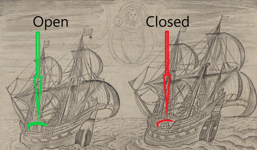

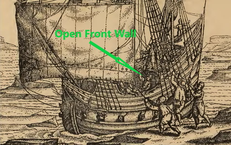

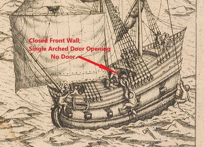

These are the two pictures that I base my comment on that both options are historically correct.
Open Front Wall
Closed Front Wall
But now it gets even more interesting. Just look at this picture.
Here we also see that the front canopies show a difference - with one being fully open and one closed. (Note the single arched door.) This what I meant by saying that you simply cannot underestimate the value of these pictures. What simply seems like a generic drawing, in actual fact shows a remarkable amount of detail. Also notice that the two transoms are drawn completely differently. This drawing though, raises an important question. Can we assume that the ship with the closed front canopy would be the one with the closed center canopy too? Conversely, can we then also assume that the one with the open front canopy is the one with the open center canopy? It would certainly seem logical. The problem remains though: there is absolutely no way of knowing which one of the two was Barentsz's ship.
I have said from the beginning of this build, that aesthetics, should not play a role, that it should be function over form at all times. But ... seeing that both options are plausible, aesthetics can come into play. I have relied heavily on the picture with the closed front wall during my build. My mind's eye sees the WB a very stout and stocky little ship, which is very much accentuated by the front wall. With the front wall open, the ship appears too long and elongated compared to the picture. Therefore, I think I owe it to myself and the little ship to give the front wall another try ... sigh.

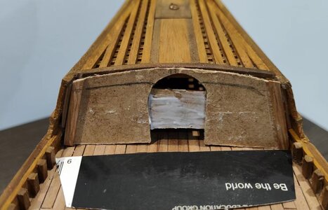

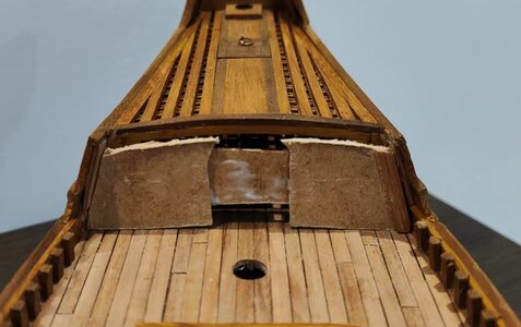

Tonight, I will take you on a rare and gruesome (at times) tour of the construction process of the front wall. I have said many times that I build in an unconventional way and without any precision tools, the steps taken are sometimes rare and cringe-worthy at times to say the least. Now bear in mind that at this stage I still have no idea whether this effort will be successful or not. I think there is hope, but in this game, you never can tell until the last moment.

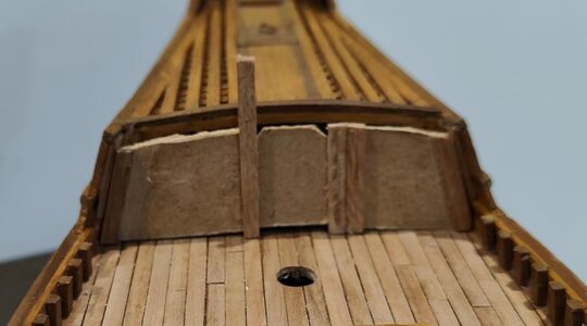

I started off by cutting out a rough template from the deck sheet of the kit. Because of the extremely narrow part that is left above the arch the whole thing is super flimsy and just wanted to collapse. A crossbeam was tacked in place with PVA to hold the assembly secure while I positioned it correctly.
After about 15 minutes the crossbeam was secure enough that I could remove the wall from the ship, glue in a substantial and permanent crossbeam at the rear of the wall and remove the temporary one placed at the front. If it looks terrible, it is because it was terrible-looking - cringe-worthy I tell you.

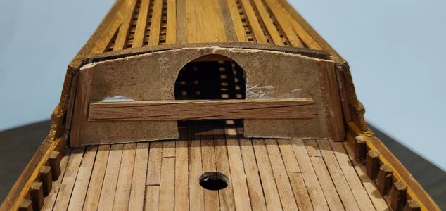

As the rear supporting brace was drying, the connecting piece above the arch was removed as it was too damaged to play any further role in the construction.
It was subsequently replaced by an equally rough-cut door template which was glued into the rear supporting brace.

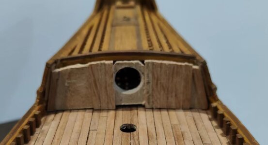

The door [posts were glued to the template in their correct positions and the planking started. This version saw the third planking variation in my efforts - vertically as per Ab's plans. Clearly the overlapping planks and the horizontally placed ones did the assembly no justice, so attempt #5 saw vertical planking being employed.
With a fair bit of planking done around the door arch area, a pilot hole was drilled and enlarged with round files to give me an idea of the door arch positioning.

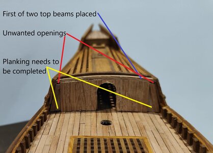

And then I got really busy and forgot to take some vital pictures. In a nutshell, the rest of the planking was completed sands a few corner pieces (the opening which is to become the arch was also planked over). The top of the wall was filed and sanded even and the first of two beams (this one a 2mm x 3mm beam) was glued on top of the wall across its entire width. The arch door was then cut and filed out from the back.
This is then where I am right now in the process. The two red lines indicate two gaps where the side borders of the front wall do not butt up nicely against the crossbeam across the width of the wall. Those two pieces have to be removed and made over so that they fit snugly against the crossbeam. The yellow lines indicate the two corners that still need to be planked.
As I said, I have no idea whether the final effort will be successful, but the lines and symmetry all line up, so it looks promising. Stay tuned to the next episode of the horror movie, "The Wall has Ears... "

I am sorry my friend, i know that you have put a lot of effort in this attempt, but i am not overwelmd yet.
For instance, is this frontwall going to fit snuggly against your canopy, or is this the right position, and if so, how dow you make this connection neat and tidy?
ROTFROTFROTF My friend, I do not blame you one bit for not being overwhelmed at this stage - neither am I ROTF. But I promise you the fit is very good and that is all I was trying to achieve at this point. The finishing off and making pretty part has not commenced. Watch this space ;)
