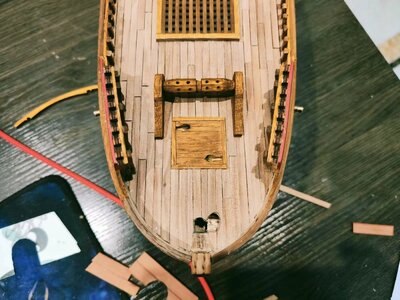

While I am still fighting with the front wall - something that at the rate I'm going now, will continue for the foreseeable future - I assembled, stained and dry-fitted the winch.
Finally, something that went together without a hitch, but that is probably because @Kolderstok Hans custom-made it for me. ROTF Once again I am in awe of the workmanlike effect that the CLOU stain gives the oak.

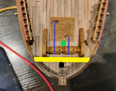

Tonight, I am very happy to be able to say that the correct position of the windlass and ancillaries have been determined after a final consultation with @Ab Hoving. Let me share with you, the layout.
The position of the windlass in front of the front canopy is self-explanatory. My much wider, rounder - and more importantly, correct - bow has finally created the space as it was on the real ship. The ancillaries are as follow:
1. Belaying rack (Belegbank) - Yellow
2. Knighthead (Knecht) - Green
3. Windlass stop (Pal) - Red
4. Anchor cables - Blue

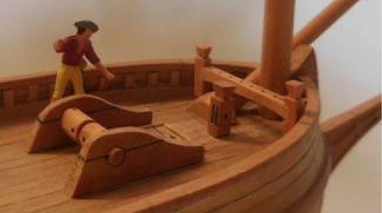

The big news here is of course the absence of the mooring bitt (ankerbeting) which has been confusing part of this build since day one. In Ab's words: "Mooring bitts were used for ships with capstans, while on smaller vessels the windlass doubled as mooring bitt as well." The layout as it is shown above is the CORRECT one - compare it to the layout on the replica.

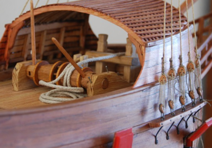

Here the winch is placed underneath the front canopy (where I have it on WB #1 with the mooring bitt in front of it. I am not going to comment about this other than to say that, that is the final nail in replica's coffin as far as I am concerned.
This also negates the models of Koos Weestra (below)

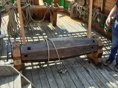

Constant Willems (below)

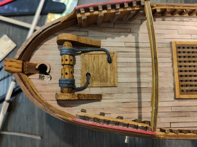

and my own WB#1.
My motto - "Persequi Veritatem" - Pursue the Truth is intact.

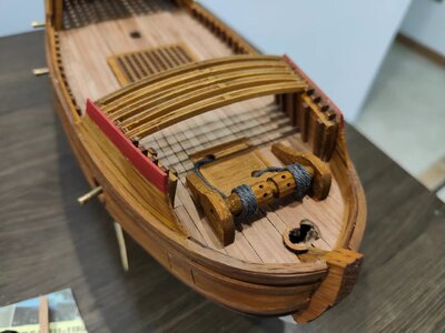

Secondly, I have reached a personal milestone. After a huge amount of research and consultation with Ab, the windlass (braadspil) has finally been placed and the anchor cables installed.
I am very happy with how this has turned out so far (I say so far, because the belaying rack still has to go between the foremast and the winch and the knighthead, the winch-stop needs to be installed between the winch and the hatch and finally, the hand spokes for the winch need to done). It will be a tight fit, but it is exactly how it would have been on a small ship like the WB whilst the whole installation is 100% realistic in its functionality. The rope that Kolderstok has supplied as "cabling" works for me and I am very happy with the color. I am even happier about the fact that it is correct! Now I have oodles of space for the lifeboats!

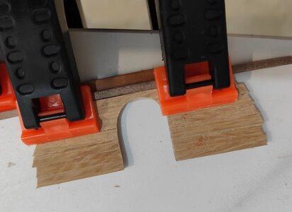

lastly, the final version of the center canopy's front wall is under construction.

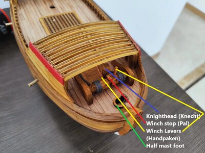

Further Progress.
Except for the belaying rack and pins which will be placed between the foremast and the winch, everything is now complete in the bow.
1. Winch with anchor cables installed.
2. Knighthead (Knecht) with Winch Stop (Pal) installed.
3. Levers for operating the winch (handpaken) installed.
4. The fabricated mast foot for the foremast is only semi-circular as the bowsprit has to go in on the other side.
The center canopy front wall is still proving to be a headache.

Thank you, Peter. I am very glad that you like the windlass - coming from someone with your infinite talent and skill, it is sincerely appreciated. To be very honest, I still think the windlass probably looks "nicer" underneath the canopy (less cluttered bow with everything spaced out more evenly), but then that is not the point.
