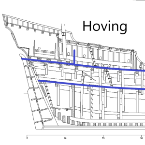

In his book HET SCHIP VAN WILLEM BARENTS EEN HYPOTHETISCHE RECONSTRUCTIE VAN EEN LAAT-ZESTIENDE-EEUWS JACHT, Hoving writes:
“It is striking that in paintings and drawings, even when it concerns relatively small ships, two completely continuous decks are often depicted. This probably had to do with the…… necessity to place the armament as much as possible in a dry spot, out of reach of rain or barrel water. Based on the smooth line which the gun ports follow (neatly between the timbers along the entire length), it appears that both continuous decks were not bent or even lowered in the aft ship (to give the guns a stable platform), but that the deck ran unbroken from front to back.
Hoving's interpretation of the deck configuration.

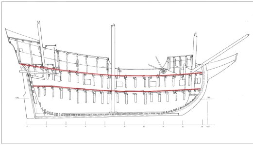

Gerald de Weerdt had pretty much the same take on matters. “The ship had two continuous decks; the lower one carried the artillery. - The decks follow the curve of the bilge timbers.” However, examining De Weerdt’s drawings, it is clear that the orlop deck is "bent" at the stern. (See picture below)

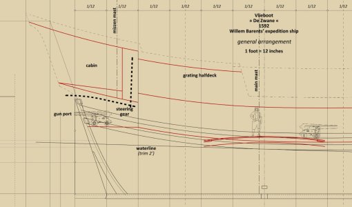

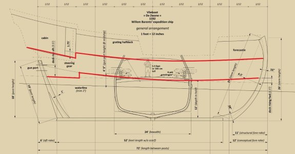

I have finally arrived at the following solution for the deck layout in the aft section of De Zwane hull. It is essentially the same as what Heinrich has already shown above, only in slightly greater detail.
In my opinion, generally speaking and in this specific case as well, the necessity or possibility of incorporating a step in the decks is not so much related to the placements of the cannons, but primarily to the relationship between the heights of the decks and their rise in this stern section, the height of the stern post (which should be as high as possible for the structural strength of the hull), the appropriate placement of the steering gear, and, at the same time, the need to reduce the hull height as much as possible for navigational reasons.
Furthermore, as Heinrich already pointed out, the very contracts for vlieboots mention these steps (of various amount), and, moreover, there is an interesting provision for (in loose translation) „construction of something akin to a cockpit within the cabin, similar to a helmsman’s station, as found on fishing boats”. This specific provision is reflected in my interpretation as shown in the diagram below.
It is also worth noting the position of the mizzen mast relative to the steering gear components.
Oh, and it’s also worth mentioning that one of the advantages of the proposed solution is the comfortable, near-horizontal deck inside the cabin itself.
This is an excellent interpretation of the build contract, @Waldemar. I don't think it is possible to follow more accurately than what you have done.
Quick question: Would the mizzen be inside the cabin or can the cabin wall still be positioned directly behind the mizzen towards the stern?
And that is a very good question :).
On the one hand, amongst all the others, there are two engravings from the expedition that show the mizzen mast in front of the cabin. I have already shown them in my thread, but here they are again to help follow the narrative. On the other hand, all the others show the mizzen mast set well aft, which is, incidentally, advantageous from a sailing point of view and seems more correct.
At the same time, at least one of the contracts specifies the cabin length as 12 feet, so placing the mizzen in front of the cabin bulkhead would result in its unsatisfactory, overly forward position.

In order to possibly reconcile all this evidence, the length of the cabin could be measured not from the aft perpendicular, as it is now, in the current stage of the reconstruction, but from the rear edge of the ship's side (the dashed, sloping line in the diagram), which is still possible.
I understand perfectly! Even better! Thumbsup
