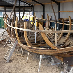

First frames are installed. Note the portion of the hull (shell) which was constructed before any framework was added. This is the classic Dutch shipbuilding method of shell-first.
Frame futtocks.

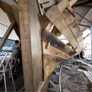

The first wales are in place. Notice the scarph joints.

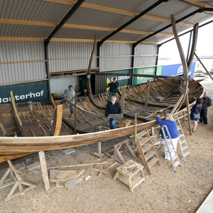

The caption underneath this picture read: "worstelen met spanten", translated "fighting with the bulkheads/frames".

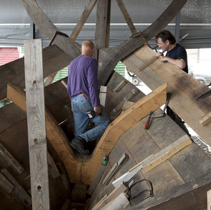

Working on the stem assembly. Here you can clearly see the different lines of the wales on the replica ship as opposed to those on the Kolderstok model which are more upswept in nature. This represents one of the hotly debated topics of the build and we have already discussed this at length in this build log.

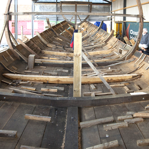

Placing the deck beams into position.
Fighting with the wales at the stem.
