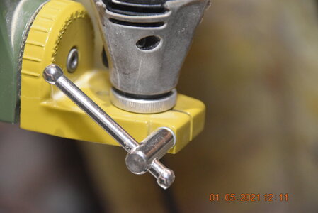

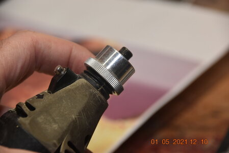

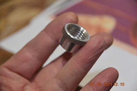

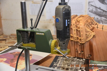

I just wanted to say 'wow I found it' and I can see now that others were quicker, but still, here it is. I don't know where to buy it because I got it from a friend but I think Micromark would be a good place to start.
Otherwise, I am not using this piece often (to tell the truth this was the first time I assembled it) - but it can be useful for those who have a Dremel and a Proxxon stand. And reflecting on Jim's comment yes, the setup is time-consuming but still worthwhile if ie. I use the drill stand once a month or so.

I am usually using the Proxxon or the micromotor free-hand but if the hole has to be perpendicular to something there comes the drill stand. Provided of course that the piece fits underneath the drill in the stand.

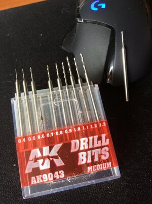

Here's my two bits worth.........har,har........ had very good results with these,
