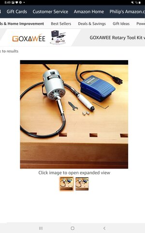

A press allows you to drill pepindicularly thereby not side loading a drill. But too much pressure will also cause the bit to deflect and break. For brass, consider using a punch (I use a Starrett spring-loaded punch w/carbide tip) to set the hole locations before drilling. Then I use a rotary tool (WeCheer - similar to Foredom) with hand pressure to drill through brass. Having a sharp bit helps. I haven't broken a bit as yet. I have a drill press if I need it.
