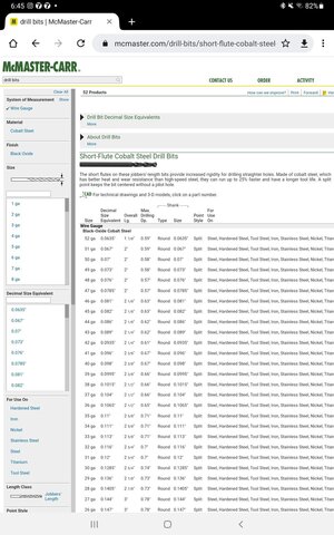

I have lots of small drills, of various quality. But in small sizes, they are easy to bend, so I'm looking for a better set that has reinforced shanks (3/32" seems to be common). I've bought two sets so far: on one, apparently the drills are separate from the hex-shaped shanks, and come loose. On the other, they are apparently carbide type used for PC boards, which as others have said is not the right type.
I guess I just need high quality HSS drills with the enlarged shanks. The Maillefer twist drills from Contenti suggested by GAStan appear to be what I'm looking for. They're just a bit pricey, and don't come in a set (where you usually save a good bit) in the smaller sizes I'm interested in. I guess I was hoping that something like this could be found on Amazon, which I usually get free shipping in a couple days. Similar-looking drills suggested earlier in this topic are carbide, which is what I usually find on Amazon, and people here are recommending against carbide drills for use in wood.
