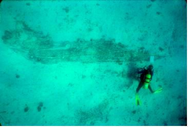

This photo of the part of the knee of the head that was found, then covered over by Irma several years ago is in Josh Marano's report but I had trouble downloading it. He just now sent it as an attachment to an email. As he mentioned it is not super clear, but I hope some of you will find it interesting none-the-less.
