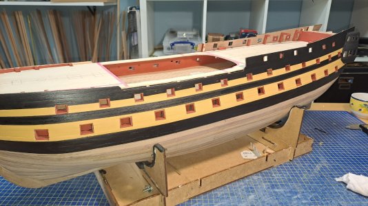

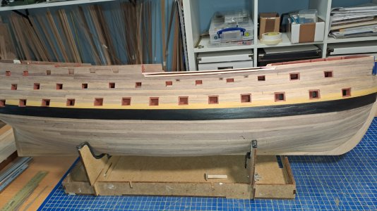

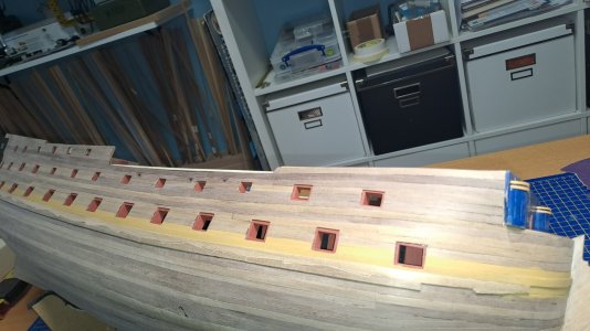

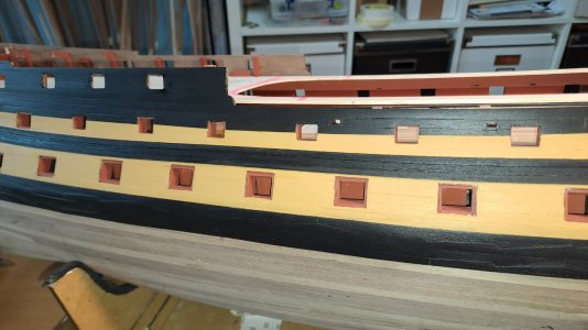

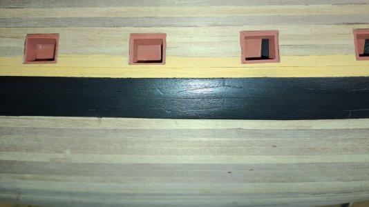

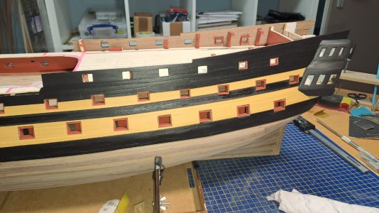

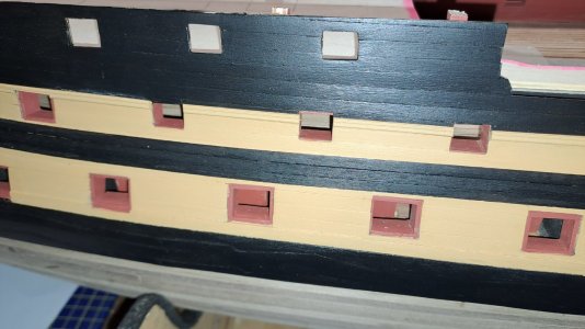

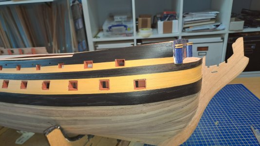

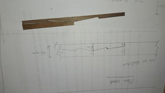

Yes, because then I'm sure to have excact the same dimension...Do you only use one template for every porthole?

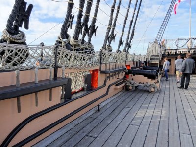

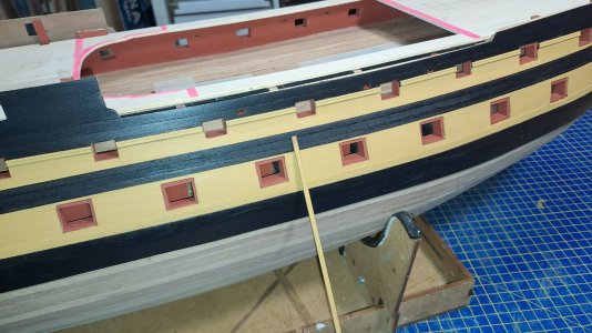

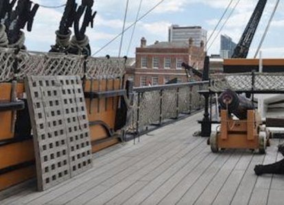

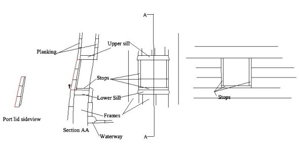

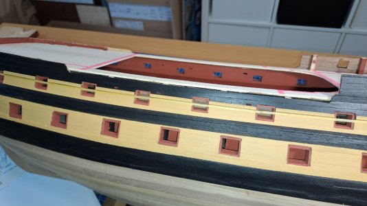

The port holes edges (surrounds) should be covered to their edge by the plankingDo you only use one template for every porthole?

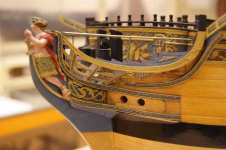

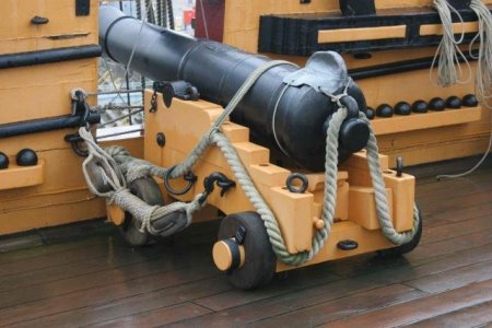

Just look at how grey those deck planks arei recon you could 3d print buckets with GR logo

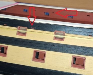

Yes Iutar, I noticed that already...but It's not wrong neither and looks good after painting the main wale...Not at all

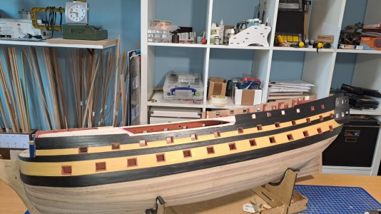

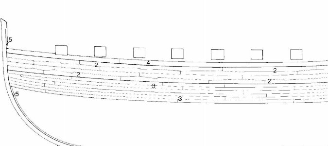

The belts were not supposed to be repeated, and they were not mirrored, and the joints were not supposed to match...
View attachment 548478 View attachment 548479

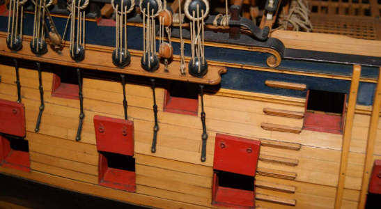

Not sure exactly what you are referring to.he port holes edges (surrounds) should be covered to their edge by the planking
Not sure exactly what you are referring to.The photos above do show the planking ending at the edges of the ports. The planking covers the sill on top and sill on the bottom as well as the frame on each side that make up the port. It does not cover the stops which are recessed and were about 1.5 inches thick. On Marc's model I believe the red pieces are the stops as they are recessed. These were found on the top of the lower sill and on the two sides, but there was no stop on the bottom of the upper sill. The internal planking covers the sills and frames as well as the stops as they extend to the edge of the sills and frames. rather than being recessed on the inboard side.

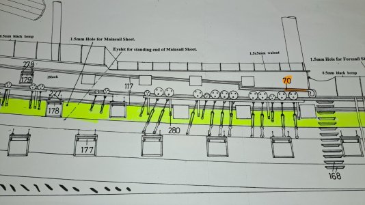

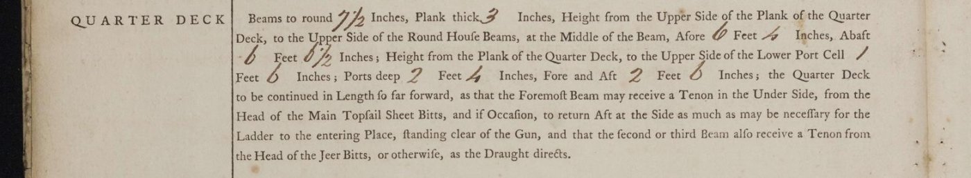

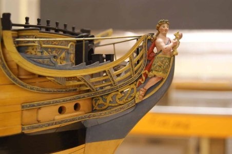

Hi Richard,Mosr ports are the same size - look on the plan

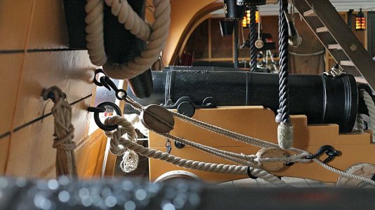

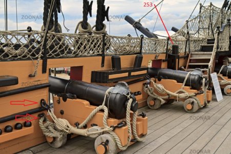

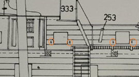

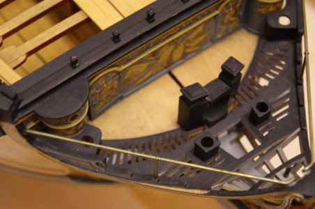

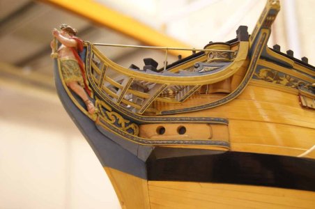

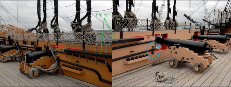

Thx Iutar!Another oddity: For some reason, the gun ports have two eyebolts each. There should actually be four!
The lower eye bolt must have a ring.

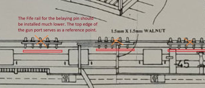

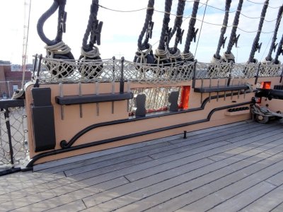

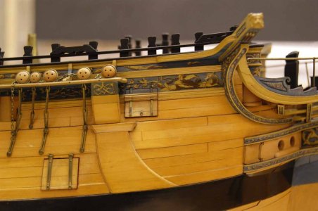

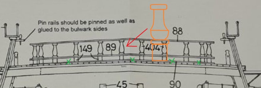

The fife rail for the belaying pin should be installed much lower. The top edge of the gun port serves as a reference point.

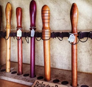

Fife-rails is not a typo, the fife-rails is so named because of its resemblance to a shepherd's pipe, that is, a pipe with a row of holes, this pipe was called a fife.

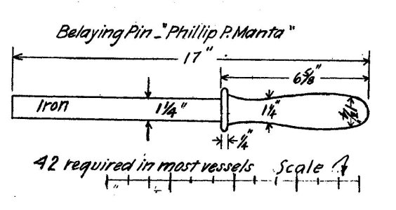

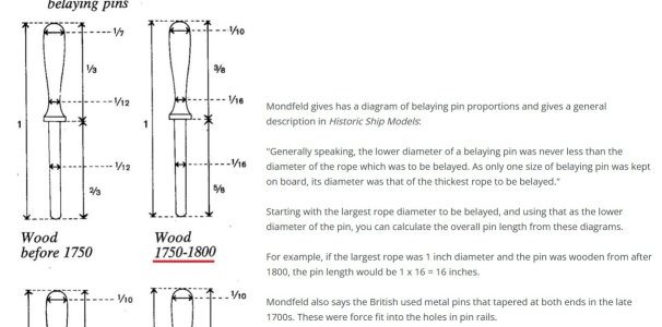

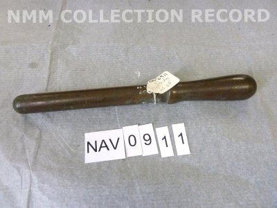

The number of belaying pins should be 12-13 per quarterdeck bulwark. See Longridge for details.
The belaying pins that came with the kit are no good; they should be thrown out. Many companies now sell high-quality replica belaying pins, and I'm sure they're easy to find in Belgium, too. It's best to get bronze ones, then paint them to look like wood—they won't break under the rigging.

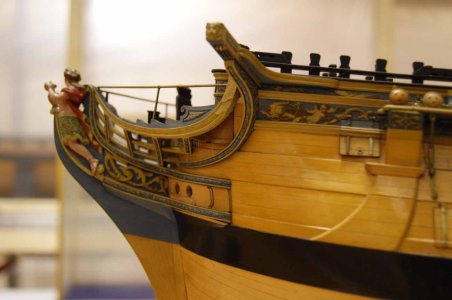

Hey Iutar,Mark, that's good. So, you've set the prototype's time period to the battle with two French frigates on June 1, 1796.

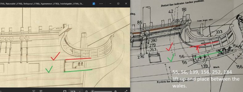

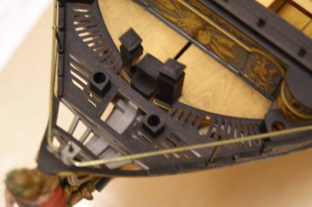

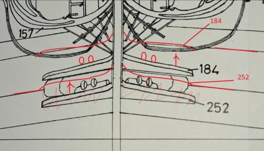

I'm concerned about whether you've done the fitting and calculations as described in post 281. You might need to raise the cutwater higher, but I hope this problem can be solved without major modifications...
