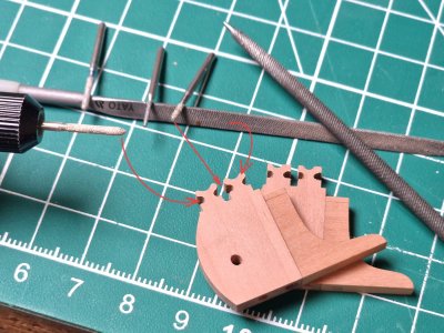

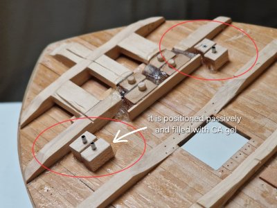

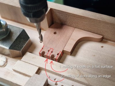

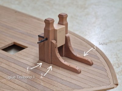

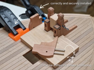

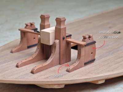

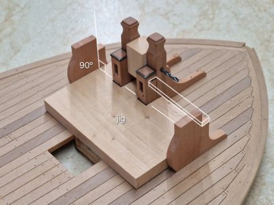

I lost practically a week to COVID and couldn't do anything. To avoid wasting all that time, I worked concurrently on 3D modeling the decorative elements and the figurehead for the *Victory*. So, let's continue with the anchor mechanism. Because errors in the kit parts mean the assembly for the first hull differs slightly from the second, I am building them one after the other rather than in parallel like the other components. The photos show all the stages, so without further ado:

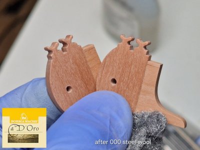

This time, I experimented with blackening. I had noticed that, over time, neon-like spots would appear in isolated areas—resembling the sheen of gasoline on wet asphalt (something I’ve shown before). Upon investigation, it turns out that internal processes continue within the electroplated copper; the blackening solution's reagents cause something to leach out, though wiping the surface with alcohol helps remove it. So, this time, I tried degreasing the parts before blackening. I started with an initial 18-minute soak in a 1:5 solution of blackening agent and water. After rinsing, and without letting them dry, I brushed off the residue while the parts were still submerged in the rinse water. Next, I transferred the wet parts directly into a 1:3 solution for 9 minutes. Immediately after rinsing—and again without drying—I dropped them into alcohol. Only then did I dry them off. Finally, I removed the surface film and polished the pieces using a soft attachment at very low speed. This produced a more pronounced metallic luster. The copper didn't turn quite as black as it usually does with my standard method, but the polishing action compensated for that. I’ll be monitoring the results to see how things change. My test pieces (anchors) had already started turning blue again, so the alcohol wipe was only a temporary fix. Acting on advice from an AI, I coated them with Danish oil and Tung oil. I applied the oil with a cloth and buffed it dry after just a few seconds. The AI claims that a microscopic layer remains, sealing out oxygen and preventing further changes to the parts. We’ll see! I’ll make a separate post about this after a couple of months of observation. On the plus side, applying and wiping off the oil doesn't alter the color or sheen; everything looks exactly as it did before. So, if this helps prevent blue spots, I’ll definitely be oiling the blackened metal. Here is the result after the blackening process. It’s a shame the photos can’t quite capture the true color, but I really like the texture and the hue. The interplay of lively sheen and deep shadows creates a sense of depth, preventing everything from blurring into a single black blob—something I really dislike.

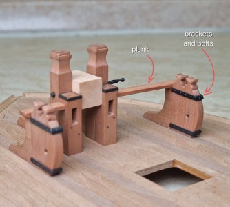

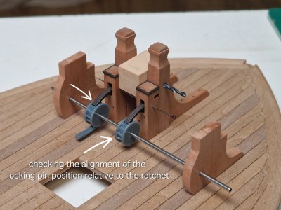

Next is the ratchet mechanism itself, featuring an octagonal beam for the anchor rope...
