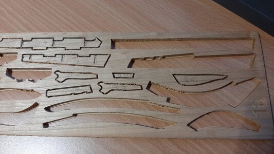

Finishing off the railings & cannon ports. I will video update shortly. NO major issues, same process as last video only less filing out & cutting. Cannon port curve parts 102-92 are not all on sheet 11 & 12. There is also what appears to be a spare set of 20 on a small separate sheet.
One thing I do suggest is with the cutout template ( cut 3-4 mm above mark line as you need the leway when you add the rails. If you cut on the line, there is a chance that some ribs will be to short after fitting the lower rail & upper rail. ( its not exact and will depend on your railing height). With the excess its easy to file down to even height. It can be fixed with replacement stubs ( keep the rib off cuts for this), but not desireable.( You can't see, but will know)

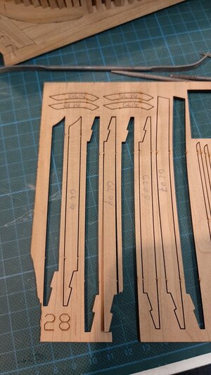

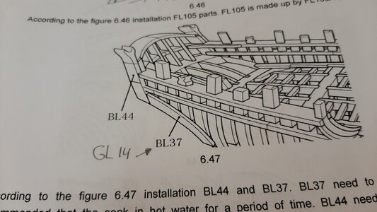

A: Remember how there appeared to be lots of parts BL37. If you read the doco You will need two of them here glued to the original one you put in. ( Yep if you've shaped and smoothed the hull, your going to re shape new parts 37 on top of the old parts 37!) This will all make sence when you get to it ( Marten I believe is at this point from a different timeline!)
or
B: BUT there is also part GL14 on sheet 28 which looks more the candidate, instead of BL 37 I will let you know!.
Also there is NO part BL44 as shown, its GL16 that is the part! ( That was nightmare to hunt out!) ( see page 38 diagrams)
All the planking is pre shaped to fit these so lay them out together first before fitting. There is a sanding template for parts GL16, but I suggest a fit and see approach then shap as needed. Mine fitted without upper sanding by sheer luck( give I altered the stern ( Accidentally, but I like it))

Hi Paul,
Agree with you, GL 14 is coming from the same thickness sheet as the wale. BL 37 is far too thick.
I will look up BL 44, think I have seen it.
HI Maarten & all
You just beat me in the verification.
I have just completed the external upper planking. With GL14 & GL16, it all fits perfectly from stern to bow. There is no sanding other than cleaning up the laser char and shaping the end of GL16 to lay flat with GL14. Fitting the 4 rows of planking was a dream and a real pleasure. They easily clamp to the ribs with spring clamps and no temp nailing or pinning is req.
No plank soaking was needed either and the bends are gentle and if done clamp by clamp they bend nicely to the hull.
The only note I will make is to ensure you check the ends were the parts join as they vary in width ( especially parts 11-13) and only match on one end.

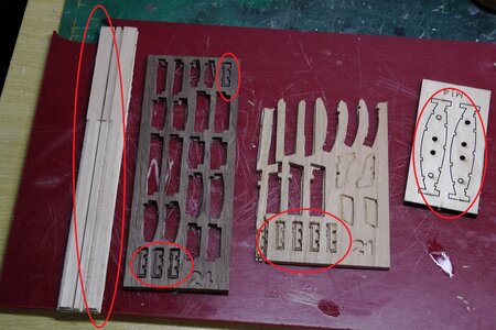

So I'm just about finished up all the deck fittings & furniture. There is a a large portion of the kit undocumented as well as undocumented parts.
The only ones I have not be able to identify are below. The white wood is obviously 2 halves, but of what ? The mast/Bowsprit( dowel is provided)
The others I cant workout, unless they are the external steps ( but there are two sets in different wood.) Anyone hazard at a guess? The Cat heads I found so they are not these.
