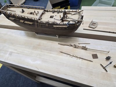

HMS Endeavour 1768 1:60 by Artesania Latina

I started mine over 20 years ago untill life got in the way. It is covered with dust. I was wondering if I should start with a new kit or finish this one. This is my first build.

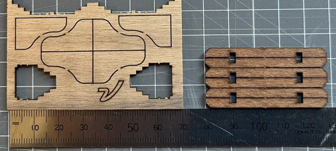

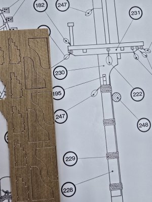

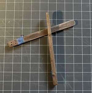

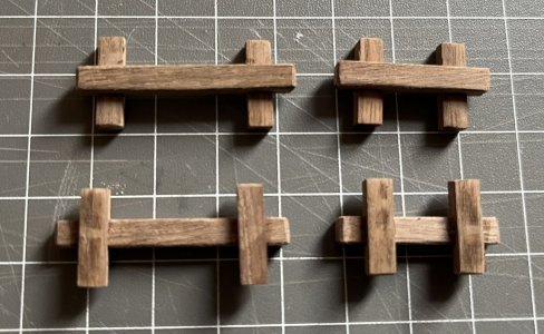

I may be missing some parts. Is there a part 230 and 231? If not scroll saw it is.
Hello dhewes,
6 x part 230 (hounds) from 1.5mm Walnut and 6 x part 231 (fore and main top trestletrees) from 1.5mm Sapele
I hope you can get the dimensions from the photo.
Best of luck,
Noel
