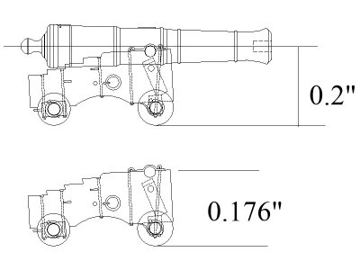

Assuming she carried 9 pounders the below should be close. Sorry for the imperial numbers. The height of the gun port would be about 5mm to the center from the deck. IF the gun barrels that you have are correct the distance from the deck planking to the top of the carriage should be about 4.5mm I believe Enterprize had 7 foot barrels which were actually closer to 7' 11" long based on what I could find.

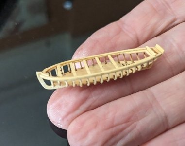

Made the small cutter this a.m. The wood is extremely thin. Still some planking (0.3mm thick!!), and finishing to do.
My advise to anybody trying this cutter model is take extreme care aligning the template and tack it with CA. I didn't glue it initially which resulted in the jig coming apart mid construction. I had to then disassemble multiple frames to get it all back together again.
Unfortunately, the supplied cannons seem very oversized. I could be wrong, but I'll check them against details in your post.
Without disparaging your skills in any way (see your 1:96 version for evidence of same) - if you can scratch 1:160 scale gun carriages out of wood that are better than what the kit has provided you will have my eternal respect. I truly hope you do it and shame me for having doubts!

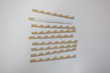

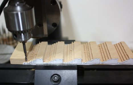

I've never made them before but seen carriages made with a mill, so I might try that.
At 7'11', I make the 1:160 cannon length 15mm. The supplied cannons are 16mm.

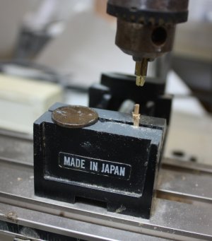

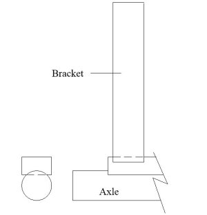

You can make a simple brass cutter to use to round the ends of the axles, although at your scale, it my be easier to just file the ends round.
Thanks. It has to be worth a try. Milling is a new thing to me, but I get a sense that a 0.8 endmill at high speed is a good starting point. I figure it'll take some R&D and lots of failures.
I might try to make small dowels for the axles and insert them. At this scale it should look fineCautious
First and foremost, at your scale, that is a fantastic looking boat. For the planking 0.3mm planking MUCH too thick if you want it to be to scale, With the rest of the boat looking so good, why do they give material that is nearly 3 times too thick for the planking? The planking on cutters according to David Steel were typically a 5/8" to 3/4" thick (0.11mm) so a bit of a nightmare at 1:160. Even card stock is far too thick but bond paper is about right and might be easier to work with.
