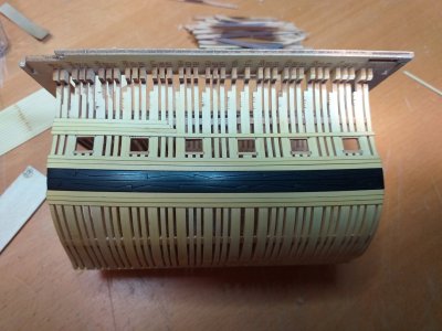

That looks really great. Really beautiful. The processing is great. Your idea with the open planks has something. I'm still thinking about whether I should do that. But I think I'd rather leave small pieces like viewing windows open. There's something mysterious about it ... Of course, I also have ideas on how to spice up this model. I think you have to be careful not to overload it because of the size. What I would like to do are the gun hatch covers. That will really make it look a bit better ...

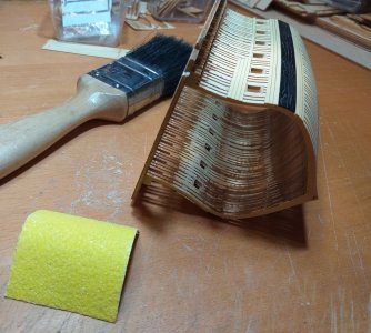

Quick question, how are you getting on with sanding and finishing the boxwood? The pear is really resistant and I really have to make an effort when sanding it ...

The port side will be planked as per normal. I'm not sure about gunport covers because the guns are on the top deck, but I agree that they would look really cool. I agree about the mysterious look of windows that 'reveal' parts of the frame. Nice.
Sanding is a real challenge. Boxwood is very hard and using constant finger pressure isn't really healthy. I have a tendency to get tennis elbow (from playing piano, not from tennis), and I can already feel the beginnings of it when I'm sanding the hull interior which is proving extremely slow and challenging..................
I imagine the technique for pearwood will be very light pressure due to the breakage risk. It's the same for the very thin boxwood.

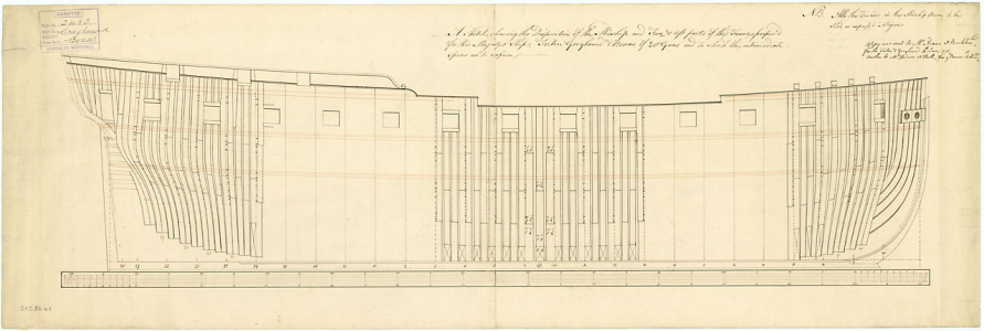

The framing there is complete fantasy so maybe not a good choice if this kind of thing matters to you. Your call of course. If you want to be more exact maybe use the contemporary drawings of the modified Mermaid class of 28's of which Triton was a part and do your own thing. These include Triton, Greyhound, and Boreas. There is a full set of contemporary plans, including framing disposition drawing at RMG Collections that could be helpful. (See below example) They are definitely better than the framing on the MSW builds which seem to be Hahn style versus actual build style with chocks and the dimensions look wrong, especially the top timbers. There is a contract for the Aurora (28) 1776 that may not be exact for the Mermaid modified class, but will be very close, if not exact, regarding scantlings for the floors, futtocks, and top timbers of the frames as well as planking, etc. Goodwin writes that at this time the joints of the futtocks were either scarph or chock. The contract for Aurora (78) 1776 calls for 5' 11'' scarphs, but I have no idea if there were scarphs or chocks or a combination of both with chocks on the lower futtocks and a scarph to the top timbers on Triton.
Framing for Triton 1773, Boreas 1774, and Greyhound 1773

I do not have that book so cannot comment. I trust Goodwin's research above many others, so unless you can find conflicting information from contemporary sources on your own, it should be fine trusting his information. I assume he used the drawing from RMG ZAZ5628 in his research. It is one of the few plans that show proposed carved works on the galleries and stern although not useful for your cross section.
