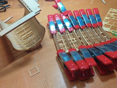

Not a lot done today.
Added some beams in the hold and the mast step along with a platform. Made a hatch.
Hardest part was assembling the orlop. It is made from five very thin pieces sandwiched and lamped to templates for the curve. Plenty of areas broke. Will disguise the breaks later before cleaning it up. I will breath a sigh of relief when it is installed, but still have the gundeck to do in the same manner and I'ms truggling to think of a way of doing it that would preserve it better?

As you can see the deck layering alignment is off in places. The pieces are perfectly made, but they must have slipped during glueing. I really have to try something different especially for ther gundeck which will be more visible. Even with the greatest of care pieces were breaking. This is a very tricky section. The small platform in the hold was easy and a good practice piece, but the other decks are challenging.
Maybe for you extreme care is required due to the lower strength of the pearwood.

Do you think that wetting the wood on the side that will be the top (convex) side of the deck would help? The moisture would tend to swell and soften the wood just on that side, perhaps making it easier to bend. Keep it clamped to the form until it dries.
Actually, I tried to lightly steam it, but it wrinkles immediately so I had to clamp it quickly into the jigs.
This might help for the next two decks Richard. I used scrap wood from the berth fret and glued the templates to make a jig. It was a lot easier to remove the clamps without damage to the thin wood:
Don't look too closely at my efforts, I gave up trying to remove the scorching after damaging so many parts :(.
Cheers
Tom
Cheers
Tom
Great idea Tom. Thanks. That will really help with the gundeck.
