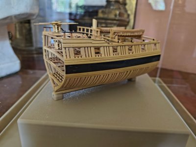

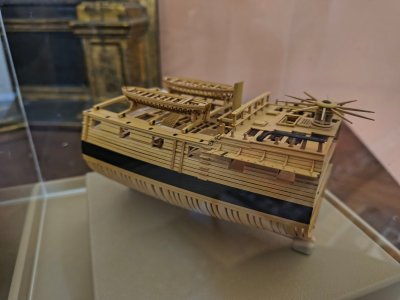

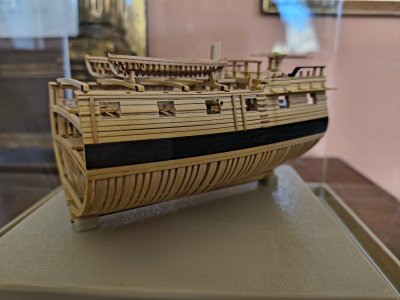

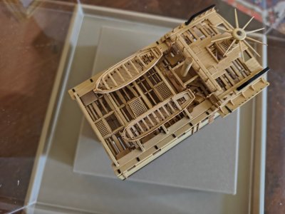

Almost finished.
Only one scratch-built cannon at present. The rest to be completed when I have my material thicknesser up and running. Still a little general tidying up to do. Various other elements to add and a couple gratings to be installed, in the propped up position. Thanks Gunther for that suggestion :) .
Overall I'm very impressed and extremely satisfied with the kit. I hope to see more builds so it will encourage Unicorn to release a bow section? I'll definitely make the stern section at some point, and the bow if it is released.
The concept, design, templates, jigs, materials and instructions are all really good. The order of construction for the major structure is very logical. A few minor niggles. I'm not wild about the laser-cut gratings or the default cannon carriages. The guns themselves are excellent, as are all the etched brass components as well, but the carriages are good enough at this scale as it is a complete kit.
Considering the extremely thin material supplied and the very small parts, which really helps with the sense of scale, the precision possible is really good. It's a cutting edge kit and real achievement from Unicorn.......................
SCRATCH-BUILT CANNON CARRIAGE.......................................................
View attachment 557780View attachment 557781View attachment 557782View attachment 557783View attachment 557784

Beautifully done Richard, How did you get all the char off those thin pieces?
I also agree the kit is very well made and the instructions are pretty good.
My canon carriages don't seem to be that bad on mine and will probably use them.
Neil
Thanks Neil,
I use files and blades to remove the char. The carriages are completely serviceable, but I need to start making my own stuff as I'm really aiming at scratch building, so along with scratch building the steps, it seemed a good place to start .
Just take thin (non-gap-filling) CA, soak it into the wood, and allow it to set (might have to mist it with water). This gives the wood a bit more internal integrity making it is less likely to flake or crumble - at least in theory. I have seen it used by those doing marquetry and wood turning (and model ship building).
I can vouch for the integrity of CA glue when mixed. My aircraft maintenance business at Van Nuys airport back in the day used CA mixed with baking soda to fill in chips at the edge of steel propeller.
It got so hard when had to use a file for finishing.
Hi Ted,
I took flying lesson in Van Nuys in the early eighties when I worked in the valley. Great memories.
Regarding CA glue, I sometimes use it on the road to repair piano hammers, (but not on expensive pianos). The hammers take a surprising amount of punishment but only have thin shanks. When they break, CA and accelerant results in a rock hard repair. The only problem is the tone of that note changes because the hammer shank is less flexible. It attacks the string harder and doesn't bounce away from it quickly enough, and that suppresses the upper partials making the note a little muted.
I found that when used on boxwood, the wood became TOO hard for my liking. Furthermore it could no longer take PVA or hide glue well.
