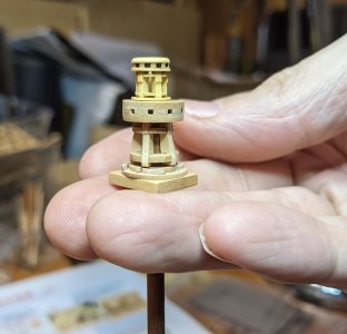

Started on a pump and will complete next time I mix up some epoxy..........
Fabulous Richard. Wow those are the tiniest pumps I have seen. Cheers Grant
The more photos you post, the more impressive both the kit and your model! The detail at this scale is truly impressive.

Pumps, stairs, knightheads and rails plus various bits completed.
Took a diversion today, with my new laser toy, and started on the scratchbuilt cannon carriages. Based on the Armstrong pattern, but still some refining of dimensions to do. Looks very promising and sits at a decent height on the deck. Yet to be made correct thickness and compared below with the Unicorn offerings.
Must straighten that pump up..................
