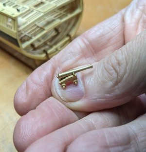

Current problem is lack of material, even for prototyping. I'll try the prototype today, but have very little material.
Overall dim is 8.4mm x 3.5mm, but that may change. Wheels are about 1.3mm with 0.5mm axles.View attachment 554999
Material is 1mm for everything at present, but all of this may change.
I am not confident at this point that it is going to be as easy.

I did manage to make one piece by hand but it was so-so and took a very long time, that's when I seriously started to think laser or CNC.

Still a fair bit of refining to do.

Axles already reduced. I'm thinking of thinning the wheels and carriages a little. Trunnions are too thin, but the holes are a strange diameter.
The gun barrels are very good, and surpisingly close to scale. I'm not sure yet how I'll finish them though..................

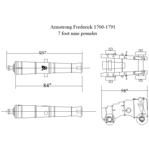

Considering your scale, the gun looks great!! ROUND numbers, the trunnion diameter is pretty much the same as bore diameter and the thickness of the brackets is close as well. Same for the thickness of the trucks. I have no idea on the length of the 9 pounders on Enterprise, but the other dimensions in question using the bore diameter for a nine pounder (4.2") should be OK.

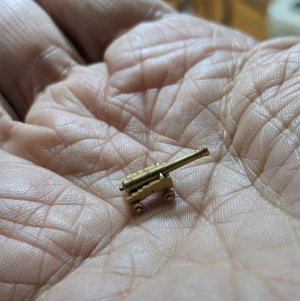

I'd like it to get it a lot closer. I've reduced the axle length and that has made an improvement. Next will be thinning the trucks and the sides of the carriage. The trunnions are a nuisance as I'm pretty sure they require 20 swg wire which I don't have at present. I might sand down and satin polish some 19 gauge.

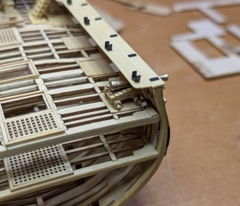

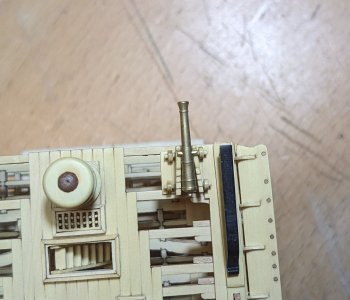

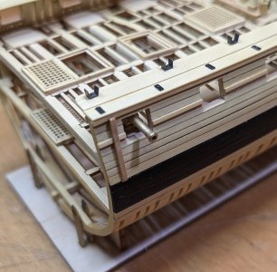

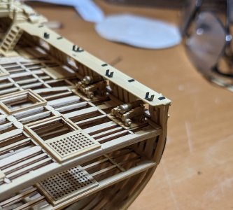

Almost finished.
Only one scratch-built cannon at present. The rest to be completed when I have my material thicknesser up and running. Still a little general tidying up to do. Various other elements to add and a couple gratings to be installed, in the propped up position. Thanks Gunther for that suggestion :) .
Overall I'm very impressed and extremely satisfied with the kit. I hope to see more builds so it will encourage Unicorn to release a bow section? I'll definitely make the stern section at some point, and the bow if it is released.
The concept, design, templates, jigs, materials and instructions are all really good. The order of construction for the major structure is very logical. A few minor niggles. I'm not wild about the laser-cut gratings or the default cannon carriages. The guns themselves are excellent, as are all the etched brass components as well, but the carriages are good enough at this scale as it is a complete kit.
Considering the extremely thin material supplied and the very small parts, which really helps with the sense of scale, the precision possible is really good. It's a cutting edge kit and real achievement from Unicorn.......................

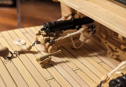

SCRATCH-BUILT CANNON CARRIAGE.......................................................
What a beautiful model Richard! Your gun carriage is amazingly crisp and clean for such a small part. You've really set the bar high for these kits. Well done!
